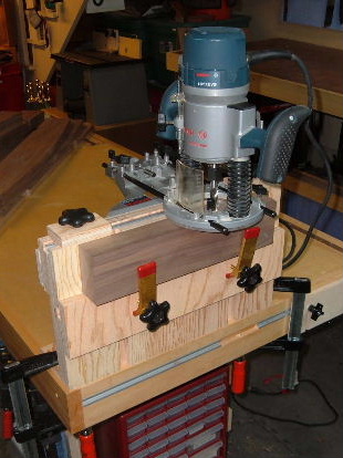

        Have you considered saving yourself all but about $20 of that and making a jig?
            Ken,
            Wouldn't that create Mortises with half rounds at the ends? How do you cut a tenon to fit that accurately?

                Some use a round over bit and router, I just round the edges with a rasp, or use a corner chisel on the mortise ends.

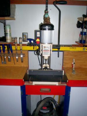

                        I purchased a Shop Fox 5 years ago (floor demo.. last one in stock for $185)as after shopping, I found it to have the sturdiest of columns at that time. It actually has "twin" steel columns that keep head travel on line even in hard-wood. It also has the longest head travel with 3 shock positions to adjust to on the rear. It does have 3450 rpm which many think is too fast. I dis-agree with that partially and if I designed a morticer, I would put it in the 2600 rpm range. Here's why...
                        When I first got the Fox, it would scorch a bit in soft-wood with that speed. I had to adjust on the fly and discover that a quick plunge and with-draw cured that. But in hard-wood which entails the majority of my work.. the Fox shines with the higher speed and gets to the finish line quicker. Since those first experiences of "getting to know your machine" days, thousands of M & T's have been cut and I do some big ones. The ones I cut on a recent completed oak table are 3/4" x 3" x 2". I do much larger ones when building work-benchs and the Fox is still running true and has not let me down yet.
                        I will give kudo's to the new Steel City morticer. I helped the Steel City folks at the recent Atlanta WW Show sell Band-saws through their distributor (Redmond & Son Machinery.. Atlanta). With the rebate going.. I saw about 30 SC morticers sold in around 5 hours till they ran out. A bunch more were sold the following day with IOU's on the next shipment which was shipped the following Monday to Redmond. Excellent machine with built on supports and table extentions backed by real "tool guys" and a 5 year warranty.

                          mortices! i am just complete a work bench and had to make mortices for the first time, and boy was it difficult. i searched for a jig or set up that i could use, and didnt find anyone that i liked. so i ended up just making a template for the the mortices that made on the base of the bench, but at the top of the bench i tried chiseling it, and those were really ugly! but i just put the top three-quaters of the bench togather today and it worked out well.
                          ken, that jig looks neat, can i ask where i can find it? i would definately give that one a try.
