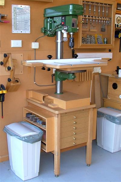

    17 year old veteran - gave great service (gone to a good home).

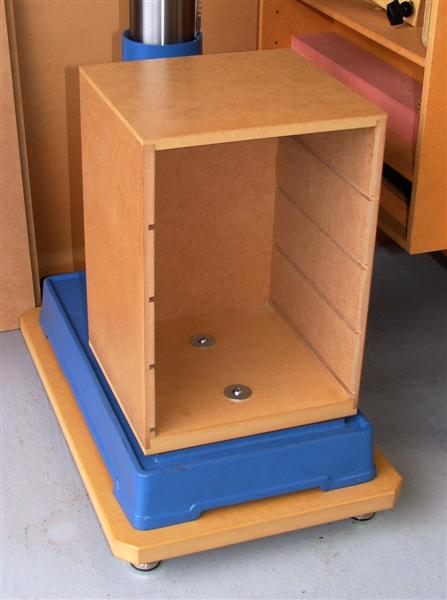

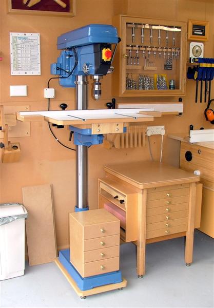

    Kirby mods:
    1" MDF base with 4 x 3/8" levelling feet, set of drawers, Link belts, top of rack screwed to the column, visible speed chart.

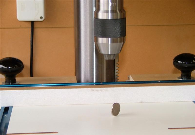

    It's a real nickel and the chuck IS spinning @ 2,300RPM

    Trivia:
    • VERY quiet running.
    • 2" more between column and center of the chuck (8-1/2")
    • Beautifully precise chuck
    • Zero run-out (as far as I could detect)
    • Rectanguler OEM table with NO holes! Had to get creative to attach my table (see pic).
    • 3-3/8" quill travel - same as the old DP
    • 3/4HP same as the old one
    • MUCH (physically) larger motor
    • 12 speed - Old one 16 speed
    • Both made in China
    • The only thing missing is a light - I'll think of something...
    Bottom line: I am a VERY happy WW'er
