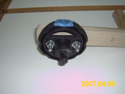

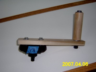

                    Originally posted by calec
                    Until some kind of crank arangement is figured out. my tension knob has a thin white plastic marking stripe. I'll try to buy an extra tension knob to attach the crank to.
                    Anyone have another suggestion for that?
                    (Don't know what the consensus is, but I back off the tension 2 turns.)
                    I made a quick crank that I bolted right to the knob. Real simple. I drilled the knob in the cross member, bolted a small piece of poplar across it, then added a handle at the end of the poplar. I can post pics, but not tonight. I back mine off 3 1/4 turns. The Key is the 1/4 turn. That way I don't forget if I did it or not. The marking (or the crank knob in my case) is in a totally different position when its not tensioned as when it is.

                          • hermit
                            • 379
                            • Somerset, PA, USA.
                            I'm sorry I got screwed up on the model numbers. Mine is the 14" BS. But... in case this helps anyone heres the pics for my setup:
