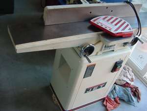

    $275 a good price for this? I can't see what model is from the pic.
    -Paul
    Evening P8...
    In good condition... an excellent price! I had a Sunhill 6" which is a Jet with a blue paint job for over 4 years. Excellent machine.. I sold it it Madmack of this forum and he loves it.
    Regards...
      • 22104
      unless something obviously wrong, $275 is great price. Looks to be very clean. Not a whole lot can be wrong with a jointer - motor bad, bearings shot, casting cracked... you can see those clearly on inspection or running it briefly.
      Jet only has one closed stand 6" model.
      Usually runs ~$600 new
      http://www.amazon.com/JET-708457K-JJ...3757610&sr=8-2

        Thanks Sarge. I'll take a look at it tomorrow. Anything specific I should look for?

            From the looks of the picture P, as Lchein stated.. it looks to be hardly used and there is not much that goes wrong on a jointer unless abused to the highest degree.
            The worst scenario is that it sits on gibs and dove-tail way and they are a pain to adjust (not that bad..but still a pain). It is rare to see a mis-alignment that requires that adjustment outside of industry. The Sunhil, had em.. my current Steel City 8" has em. I did not feel the extra for the parallegram bed was necessary as I have only seen isolated cases where the beds slipped.
            Take a straight edge.. look for heavy rust on the fence and fence carrrier (light rust there is not a bigger and easy to clean).. run it and listen to the motor for any bearing whine.. pull the rear case door and check for pulley or belt wear (belts are cheap).. check the blades for excessive chipping (again.. HSS blades are cheap) ask the owner when he purchased it and why he is selling it. He may be just up-grading but from the looks he just hasn't used it much and lost interest in WW.
            Looks like a great deal.. still smart to "look what appears to be a gift horse in the mouth". Observation on the part of the "buy-ee" will be far more valuable than "word of mouth on the part of the "sell-ee"! ha.. ha...
            Regards and good luck to what appears to be your "lucky dog day"..
