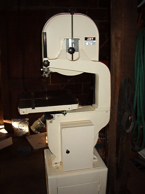

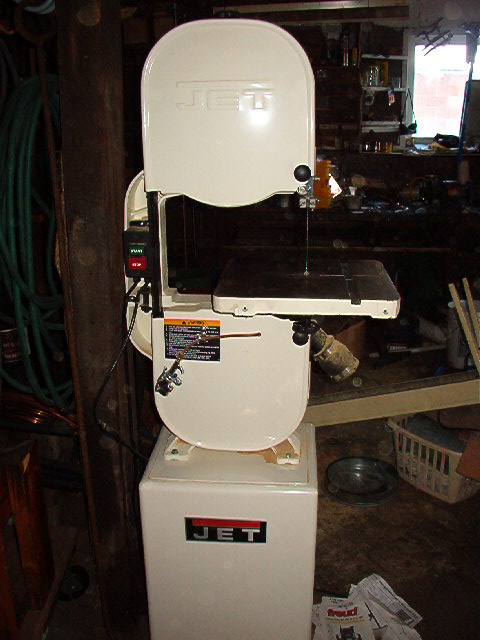

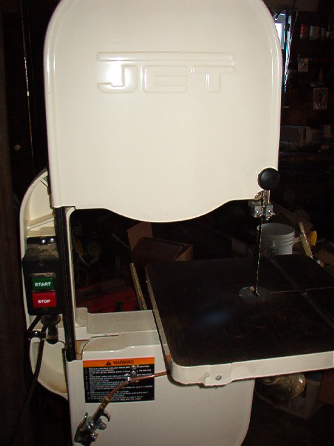

    Thoughts and opinions. On CL for $400.00 I am supposed to go look at it tomorrow afternoon.
    Model JWBS-14CS

    I really don't know much about that saw, but considering you can get it for around $500 new without even trying to look for a deal, I'd suggest bargaining on that asking price. Unless it includes lots of extras, but from the pics it looks pretty stock.

      Based on one photo, it looks like new. Yes you can buy one new for $500.00, but if it hasn't been misused, $400.00 is an ok price. Try $375.00 on him for size, carry cash with you, it might be the charm.

          looks pretty clean but there's quite a pile of dust around the base and dust port so it has been used a bit.
          No "enhancements", looks like a fence is not included.
          What's that thing on the lower front door, looks like a air nozzle?
          Since the unit is like around $500 (better check) new, $400 is not a real great deal unless you can bargain some more.
