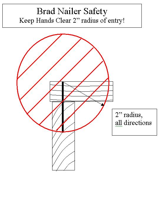

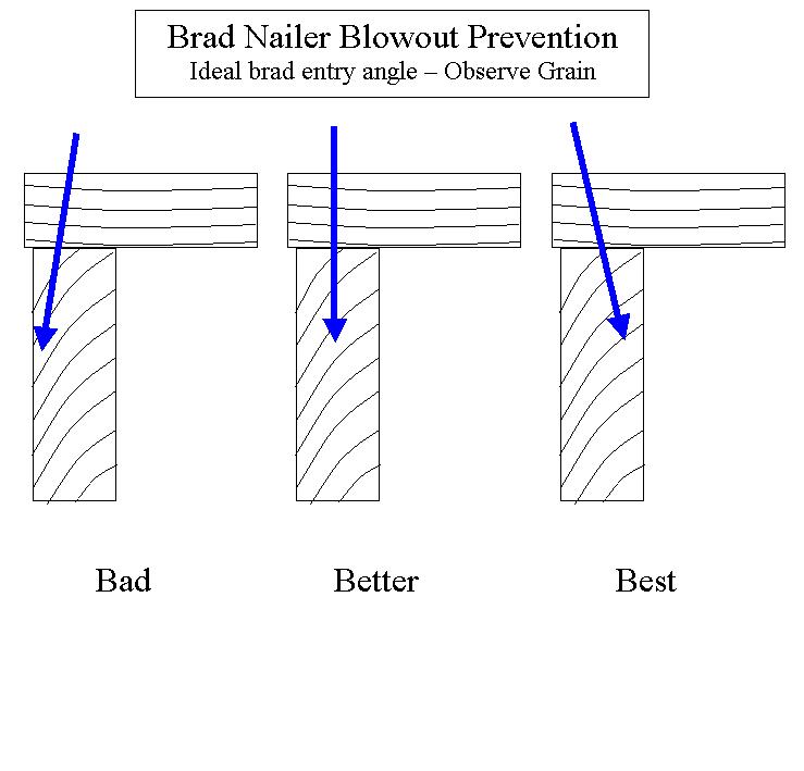

                there's two things you can do w.r.t. blowouts and brad nailers.
                1) Be aware of grain. try to tilt the brad towards obvious grain, in other words try to hit grain lines at oblique angles (more like 90 degrees) rather than hitting the grain lines at shallow angles.
                2) keep your hands at least 2" away from the brad entry point - (with a 2" brad nailer) for what now must be obvious reasons. That include from the top. I've seen pictures and heard stories of brads turned 180 dgrees and come back out the top! (I consider that a brad fired as shown can exit anywhere inside a 4" ball-shaped space.)
