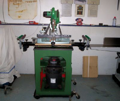

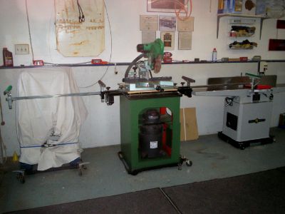

                I have a 10" SCMS sitting on a mobile stand with one of those portable stand tops mounted to it. I threw away the legs on the portable stand. This week-end I will have a 12" SCMS replace the 10" as the 10" has been sold. Same cross-cut capacity with both, but the 12" will handle stock almost 5" thick as opposed to 4" on the 10" mitre. I ran into that problem several weeks ago with some 4 1/2" kitchen table legs. I have run into it on more than one occasion.
                Here's my solution to cross-cutting which has to have a space of 4 feet to sit in my shop. But capable of extending support to 10' when the extensions are out full range. The mobile base has a shop vac on board under-neath, so sawdust is minimal.
                So.. Four feet taken that can be 4' anywhere in the shop. Capable of cross-cutting 16' stock with on-board features I added. On-board saw-dust control. And last but not least, by releasing two quick release nuts the SCMS can be lifted off the mobile base and moved to say my back deck where it can perform molding cutting duties inside the house when those little honey-do projects pop up. And they do if you are married.
                The SCMS with a little creativity is just much more flexible IMO! If you have tons of space.. the RAS has a place and especially in cabinet shops. But I don't have a cabinet shop, I have what used to be called the garage but now the wood-shop! ha.. ha...
