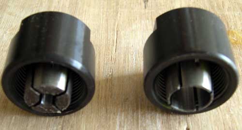

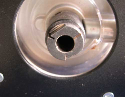

                  Originally posted by atgcpaul
                  One follow-up to the Triton 3 1/4 HP router. I noticed that it includes a 1/4" collet reducer whereas the smaller one includes a 1/4" collet. I guess from teachers and magazines, it's always been--go for the collet, not the reducer.
                  Is this a big deal?
                  The collet on the larger machine (TR*001) is "Hitachi-style", coarse thread, sharp angle of attack on the taper, very little wrench movement required - looks like this:
                  You cannot get this style of collet in any other size than 1/2" (and believe me, I've tried!), hence the need for 1/4" (and/or 8mm) inserts.
                  The smaller machine (MOF001) uses the "self-releasing" style of collet - fine thread, shallow angle of attack on the taper, much more wrench movement required - which is readily available in both 1/2" and 1/4". These look like this:
                  These still need an insert for 8mm bits (no, I've not been able to find a dedicated 8mm self-releasing collet either!), but I've never had any problems with inserts in either style of collet. Granted, I prefer a dedicated collet, but if inserts are used correctly, they're fine.
