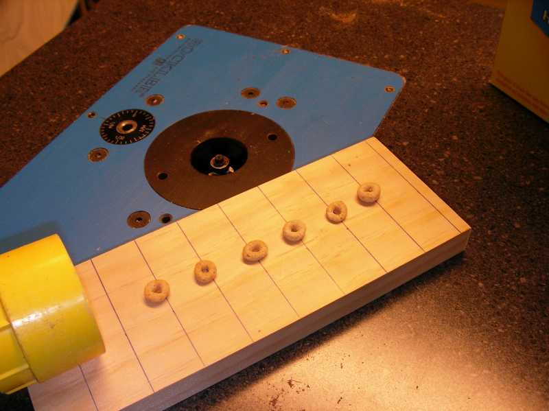

        Okay, had a little time this morning and a working Internet connection. Picture below is how I tested. I use a Shop-Vac brand vac with HEPA filter, filter bags, with a mini separator and 3" network of piping to my four machines with four plastic blast gates.
        I was able to pull approx. 1-3/4" in my horizontal pull test with the hose that normally connects to the table saw. When I bypassed my "network" with a 24" hose connected directly to the Shop-Vac, the distance increased by approx. 1/8". In both of these instances I was able to lift (vertical test) a Cheerio approx. 1".
        The results for the 1" Porter Cable ROS hose (approx. 7-1/2' long) and the Fein 1-1/2" hose (maybe 13' long) did not vary whether they were directly connected to the Shop-Vac or used through the network: horizonal distance was approx. 1-1/4" with either of these two hoses. And lift (vertical test) for both was approx. 7/8".
