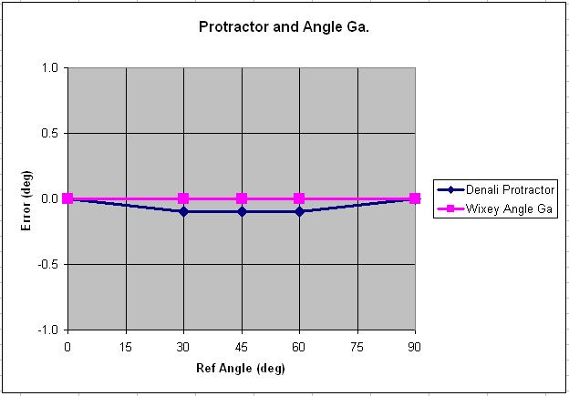

    while we're on making measurments I took some data on the Wixey tilt angle gauge and the Denali Protractor. They are a little different from each other but do measure a common value.
    The first plot shows the angle devices vs. drafting triangle(s). I used several triangles and they all read the same which I'll make the assumption that means they are both consistent and accurate. If they were not accurate, they would likely not have been consistent, either.
    It shows that the Wixey is at least spot on at the standard drafting angles and that the Denali is only .1 degree off on some.

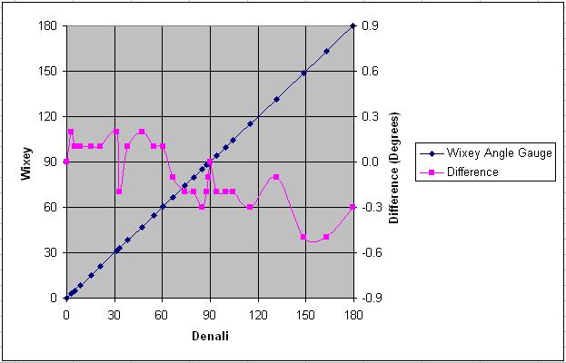

    The second plot shows the relative measurements of the Wixey vs. the Denali. I placed the Denali on a flat table, and fastened the Wixey to the arm folded flat (0&#176, then zeroed the Wixey. I then raised the arm and read both gauges over a range of 0-180°. The X-scale represents the reading (in degrees) of the Denali. The right scale and the wavy line show the relative error between the Wixey and the Denali, surprisingly it sort of bounced all over the place, the good news being it was much less than +/- 1 degree.
    CONCLUSION: The Wixey and Denali both read angles with resolution of 0.1° and accuracy much better than 1°. Their relative errors over 180 degrees was +/-.5°
