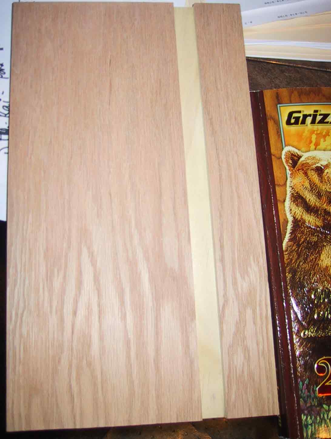

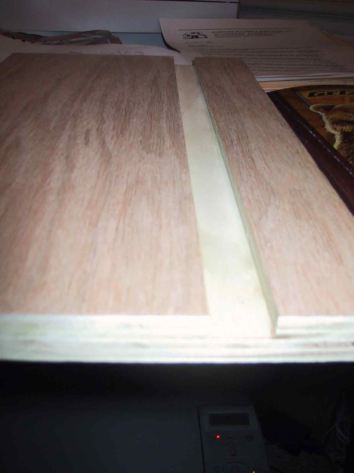

                      Check out the dado below. There is zero enhancement, ie sanding, etc to this slot. It was created with the above mentioned bit. There is zero tear out on the veneer and the bottom is incredibly flat and smooth. Creates a very nice tight fitting joint. Only issue is that as Loring mentioned there is variance between each lot of sheet goods, so be sure to measure before you buy. Other than that, I can't think of a better answer for your original question.
