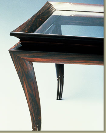

        Thanks guys...I will try HD. I have a jig....the base of the router is 1" above where I will be cutting. I need to make a deep cut because I am going to atempt the "3 way miter joint" that Micheal Fortune uses on his tables.

                      I have tried the mortiser attachment for the drill press...it works but doing it with the router is so much cleaner. the actual cut is only 2 inches deep but there is 1 inch between the base of the router and the top of the stock...thats why i need a longer bit.
                      This is the joint I am trying to re-create.
