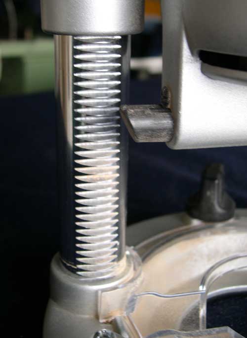

                              The spindle lock on the Triton is a captive plunger with a chamfered outer end (shown here with the router upright, above the table). As the body plunges, the chamfer engages with a cam face on the base, thereby pushing the spindle lock inwards as the body descends.

                              The Frued version looks like a direct copy of the Triton mechanism.

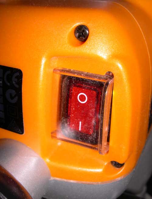

                              However, the additional safety feature on the Triton interlocks the router's on/off switch with the spindle lock. This means that you cannot switch the router on (even accidentally) with the router's power switch, because the cover to the switch is locked shut. Conversely, you cannot plunge the router for bit changing with the power switched on.
                              Inverted, most operators will switch the router's switch "on" and control the router operation from an addition switch, either NVR, or the wall outlet switch. This is fine and the Triton doesn't need any modification to switch it on, as there is no press-button release to overcome. However, in order to change bits above the table, the router's switch needs to be turned off. This is a one-second operation and no inconvenience at all.
