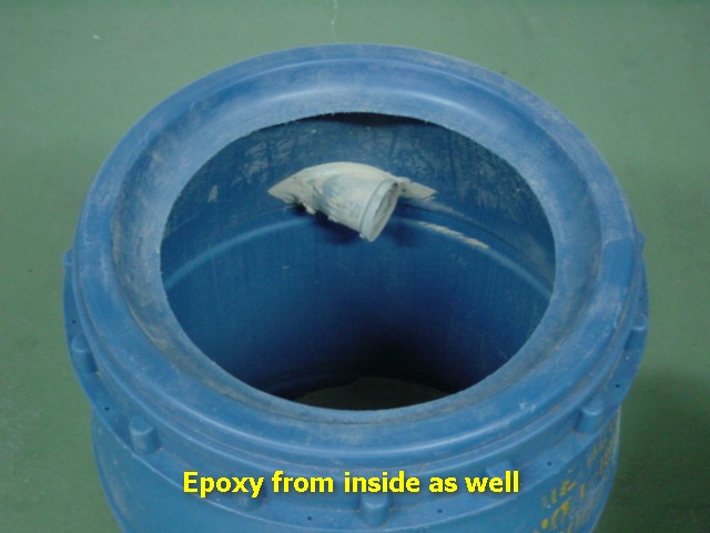

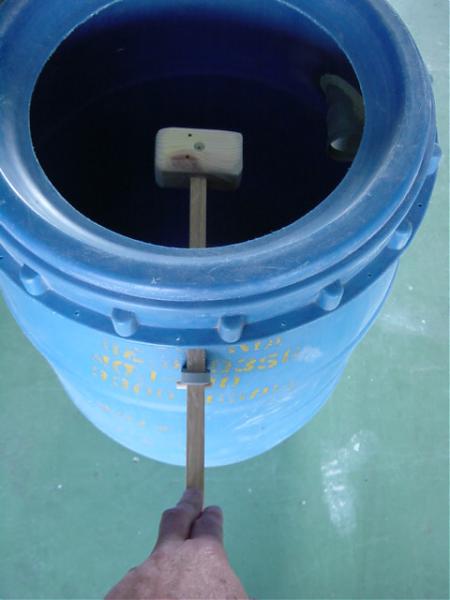

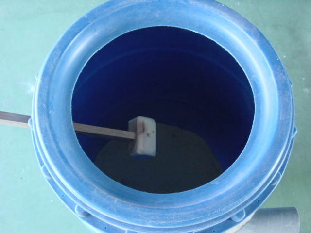

    Lately, I made some improvement...A handle with "Hammer"
    Every noe and then, I "bang" a few times with the "hammer" on the "filter" and that "shakes" the "filter" and removes most of the dust that has been accumulated on the "filter".
    That way, I don't have to clean or change the filter for very long time...

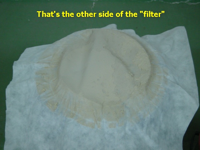

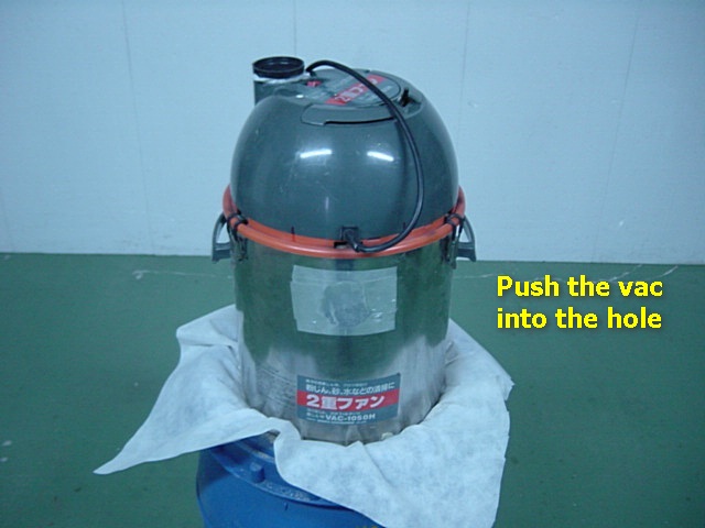

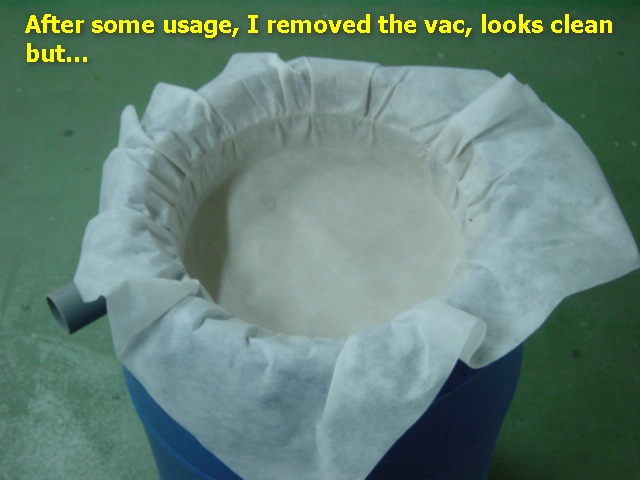

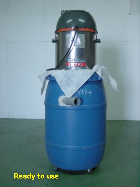

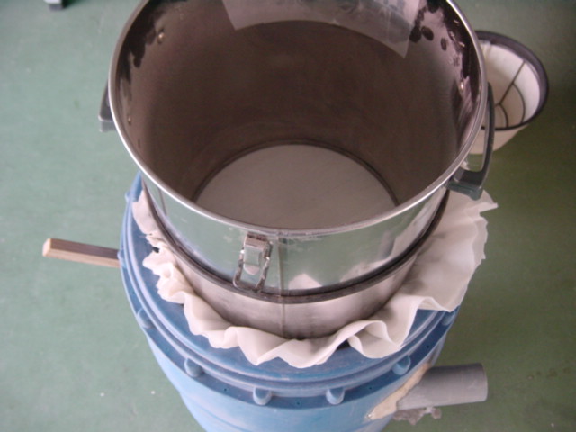

        From time to time I pull R2D2 from the barrel (25 Gallons) and replace the “Filter”, I have a few filters so I wash it whenever I have the time. It dries within 15 minutes.
        I use 2 layers of filter and the amount of dust that goes to the main (original) filters is so small that I don’t have to clean them but “once in a barrel” (I just vacuum them with another vac).
        Because it’s on wheels, I just pull it near the TS or router and use a very short hose (about 3 feet), that gives me easy “ON-OFF” control and reducing the “duct losses” (friction and boundary layer) to minimum.

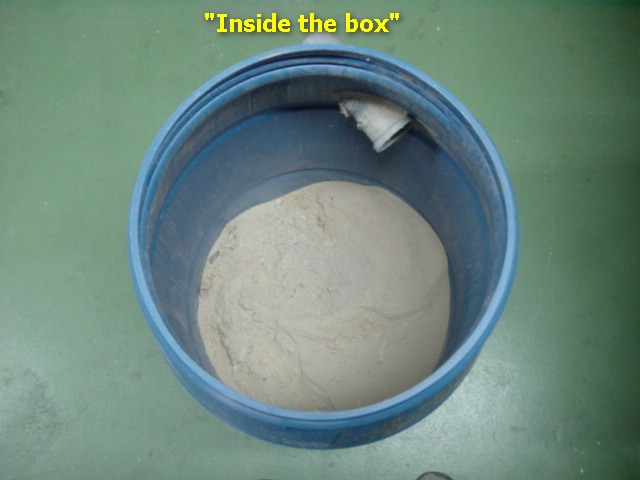

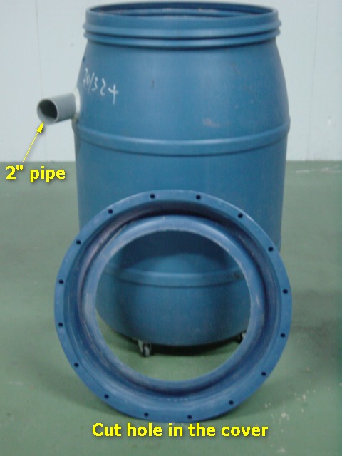

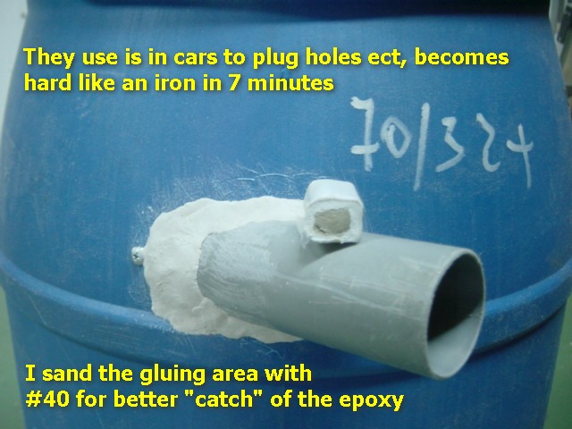

            When I made it, I had in mind:
            1. To increase the container volume.
            2. Less cleaning of the main filters (only very fine dust).
            3. To increase the airflow (considering the same motor power).
            The first two are obvious.
            I increased the flow only by changing the hose (and connection) to 2” (the original is 1-1/4”)
            The manufacturers want to sell a good vacuum pressure and they are reducing the hose diameter that gives strong vacuum but less airflow.
            If you are vacuuming a carpet, you can hold the hose in one place for another 2~3 seconds till all the dust at that point will be removed.
            In woodworking, we don’t have this option, the dust will not “wait” there, new dust is produced all the time and if it will not be removed it will accumulate and clog the hose.
            In woodworking, we don’t have to vacuum coins from the floor (as shown on TV) but rather, we have to move big quantities (volume) of air. That’s the reason that we are using 4” or 6” ducts and hoses for dust producing machines.
            There is some Cyclone effect by mounting the inlet duct at an angle to the barrel, but it not my intention to make a real Cyclone that is much bigger and requires stronger motor power to overcome the losses due to the “Cycloning” of the air.
            IMO, cyclone does not increase the suction strength (on the contrary) unless you use stronger motor.
            Cyclone, increases the separation of the dust from the air but requires stronger motor power to swirl the air.
            I use the same motor power of the vac but more efficiently, instead of strong vacuum and low airflow, lower vacuum press and higher airflow.

                    Hi Niki,
                    Thank you very much for the pictures. I am still trying to understand it though.
                    Is it that you have removed the bottom of the wet/dry vac and put it on the big blue container ? Sorry for all the questions.
