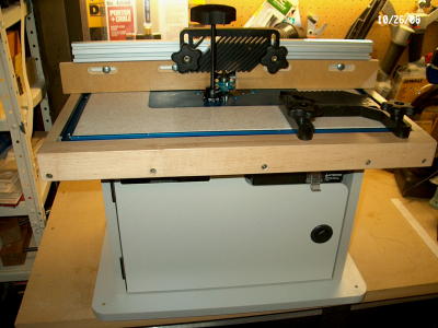

Ok here's some pics of my router table with a corian top and craftsman cabinet and fence. First is a front view showing the maple edges and the rockler alum plate.
The edges are just screwed together...no glue in case the corian doesn't work out I can easily change it to some laminated mdf.I ran a piece of t-track across the front to make it easy to attach featherboards. After reading alot of posts about router tables I don't have a mitre slot either.

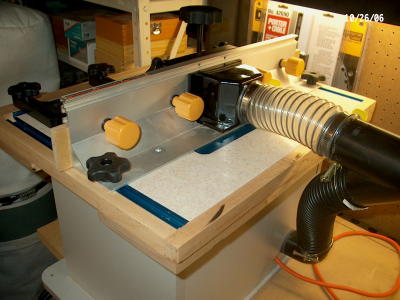

This pic is of the side showing how I attached the fence to the table with some more t-track and my dust collection set-up.

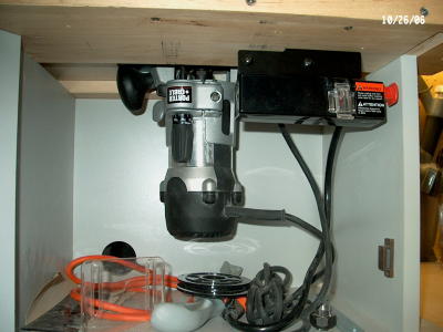

Next is of the inside of the cabinet. I dado'd the 2 bottom pieces where it mounts to the cabinet and just used the same screws that the old top did and then screwed the edges to them. I made them wide as I thought I could to support the top as well as possible.

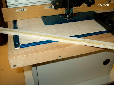

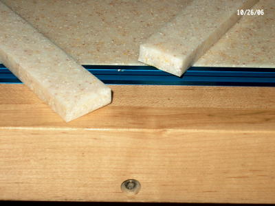

Here's a pic of one of the cut-offs after glued up with Gorilla glue and then a pic of it broke. It doesn't show in the pics but I can hardly make out the seam between the 2 pieces. I think its gonna be great...way better set-up then the old craftsman top and Ryobi router. A little wax and it slides like a dream and everything is very easy to adjust.
