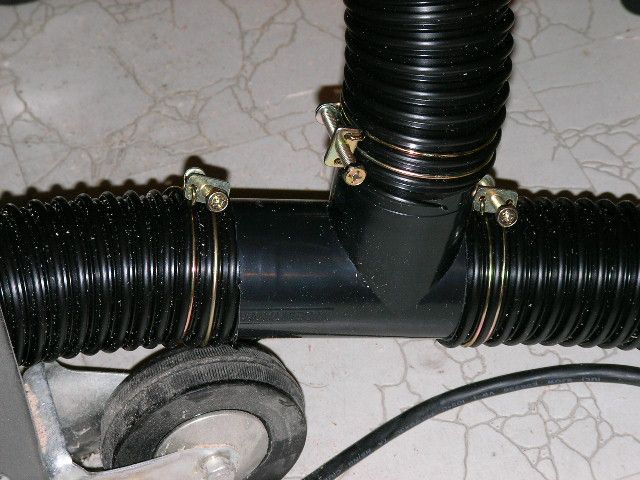

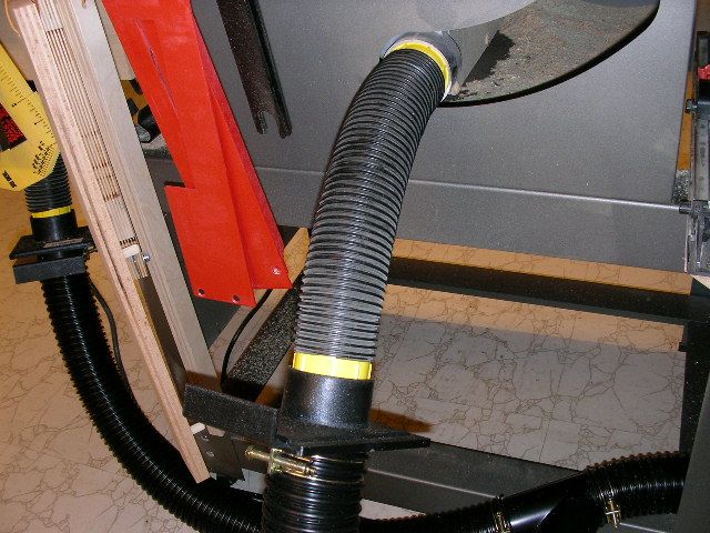

            Okay, I guess a picture is worth a thousand words. I'm uploading two thousand words. ;-)
            The first picture shows a short hose w/ yellow end-fittings coming out of the back of my BT3K. This is a standard Shop-Vac "2.5-inch" hose (albeit very short). The yellow connectors measure 2.267" OD and 2.098" ID. The blast gates they are connected to are 2.478" OD and 2.292" ID. So the yellow fitting plugs into the blast gate just fine.
            The 2nd picture is a T-fitting. The ID of this T is approx. 2.227". So I can't just plug a Shop-Vac hose into it.
            So my thought (Jim) was to use a rebate bit to make the ID in the T a little larger to accomodate a Shop-Vac hose. But of course, this doesn't work because nobody makes a rebate bit that will do 1/50".
            Loring's idea of cutting and gluing back together a Shop-Vac fitting would work, but then it wouldn't work in other Shop-Vac accessories.
            I'm thinking the optimum setup would be to enlarge the ID of the T. Just gotta figure out how.
            Don't spend too much time on this, BTW, as I have already come up w/ a workable solution. But in the future, it would be nice to have the flexibility to connect Shop-Vac fittings to the T's and Ty's.
