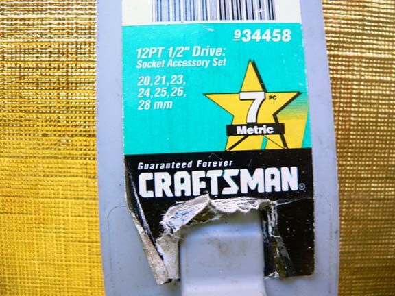

            Here's the set I got from Sears a few yrs. ago....
            You might try a local motorcycle parts store like Cycle Gear or whatever
            store Chain in your area. I'm sure you can find your socket someplace fast.
