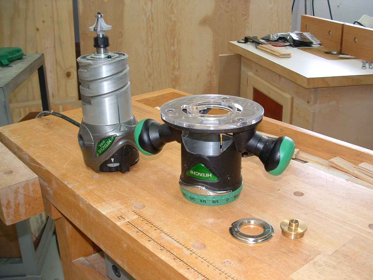

                          Mine has a clear plastic base that has a 2 5/16" hole in it so that you can use larger bits. I have a metal adapter that fits into this hole that is attached with two screws so that the PC bushings will fit it. So if the one that you looked at just has the larger hole see if there is a package that comes with it that has the adapter. Not only that but make sure that it has the small black centering tool as well as the wrench and both collets. If not you might want to order from Amazon or buy from someone else.
                          Here is a picture that shows the adapter ring sitting next to the PC bushing. Click on the picture to get a better look.
                          Allen

                            Well I'll be darned so that's how it works. Thanks so much for the reply Allen and the picture. Looks like that'll work then. I didn't see what assessories came with it so didn't know. Thanks
