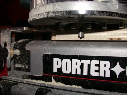

                        Here is what I'm getting at. Sorry for the bad lighting. That is a piece of 3/4" ply
                        The bit is fully extended and installed properly in the collet.
                        This is the stock PC bit, which is actually longer than most.
                        You can see that even with the Bosch insert, I couldn't do through DT on 3/4" even if I wanted to.
                        This brings up my next question.
                        On HB dovetails, what is the rule of thumb depth? 1/2 of stock thickness or less or more? The ones I've tried would only work when I cut 1/2 or less of the stock thickness. Does it depend on the jig/bit being used?
