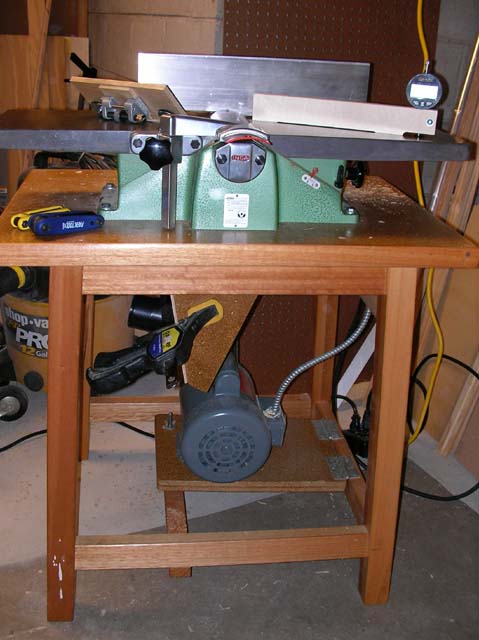

          I have an 8-1/2" jointer/planer made by Inca that has a wooden stand and a motor connected by a rather long belt (see photo). What advantages, if any, might I find in replacing the original belt with a link belt?
          I imagine these link belts only help in certain circumbstances? Having never used one, I don't know their advantages.
          Are the expensive? I've seen someone at Rockler buying one. I imagine there are less expensive sources?
          Thanks,
          Phil

              Phil,
              The major advantage to link belts is vibration reduction. I can't tell from the pic, can't you raise the platform the motor is mounted on to get it closer to the driven equipment?
                Phil,
                The other advantage is the adjustability if
                you need spare belt(s) for several machines you only need one spare
                you don't know the length of the belt that needs replacing
                you have a wooden base and some guy named Ken suggests you change the mounting to make the motor closer then having an adjustable belt will make this much easier to fit.

                  The one reason I will be adding a link belt to my jointer when I redo the mobile stand is because of memory. I've read many reports about a belt being left in a certain place and getting set to that place. Then this causes vibration in the belt that takes a while to work out. Link belts don't have this memory problem. I'm also debating adding it to my drill press for vibration issues. Although I don't know if that will make it more annoying to change speeds.

                    Uh, I believe that is MR. Ken, Loring!
                    Good point on the spare belt thing, and the point Joe made about no memory set in a link belt is good too. These things are becoming more important with each post.
