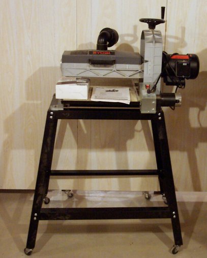

    This is a bit of a gloat, but I also have a few questions. First comes the story.
    I noticed in the classifieds an ad for a 13" Ryobi drum sander. I sat on it for a few days thinking that the advertiser must have confused the Ryobi planer with a drum sander. My curiosity got the better of me, so I called the guy last Friday and asked about it. I asked if it was really a 16" drum sander (I gave him the model number) and he was shocked to find it was indeed, a Ryobi WDS1600 drum sander. He wanted $385.
    Turns out, he lived only about two miles away. So I high-tailed it over just check it out. The seller was retiring from the remodeling business, and dispersing of his tools and such. He said he only used the drum sander for a few projects several years ago, and hadn't used it for about 3 years. Here it is in my basement.
    It came with the stand and one box (3 remaining rolls) of 80 sandpaper. It's in excellent shape, just a little bit dusty. One of the tensioner blocks and the bolt is bent a little, but I was able to order a replacement from M and D Mower for a few dollars (I had to order a few other things to avoid a handling charge). Considering that it is in such good shape, came with the stand, and he tossed in the sandpaper (worth about $15), I thought $385 was a fair price for a 16/32 drum sander.
    I have not run anything through it yet, because I want to clean it up, fix the bent tensioner block, and check all of the settings. My questions are:
    1.) How much tension should there be on the feed belt? The manual doesn't explain this very well.
    2.) I did some searching for sandpaper. . . man, it's pricey. What vendor do those with drum sanders prefer?
    Thanks in advance for the responses. I'm probably going to make a more useful mobile base similar to what Rod Kirby did for his close cousin to the Ryobi. Right now, I have a few other things to get finished first.

    The whole thing looks a little cockeyed in the photo. Is it just my eyes?

        just4, it's not your eyes. Blame the photographer. He was standing off to the side so that his shadow wouldn't be in the way. Plus, the left and right swivel casters are not even.
