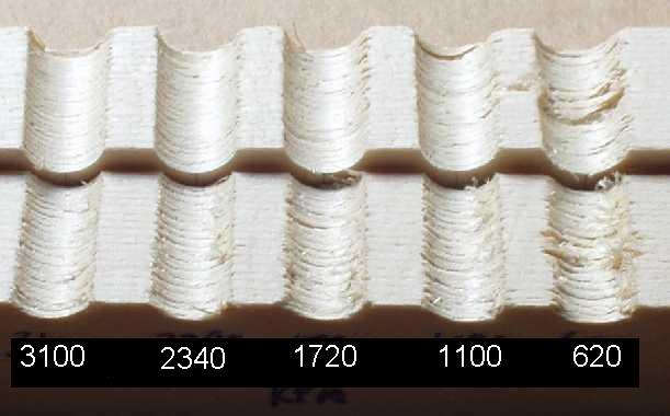

    Posted a while back, reposted by request.
    (see attached pic, click it to enlarge)
    These are like 1/4 or 3/8" bit drilled through 3/4 whitewood pine.
    Numbers are RPMs. Cut the piece in half after drilling on a D.P.
    Looks like the slow speed tears the wood and the higher speeds cut the wood.
    Conclusion is to look up and set the correct speed each time I change bits and or wood.
    Here's a chart of recommended speeds for different bit types and materials, from Wood Magazine:
    www.ibiblio.org/twa/info/drillSpeedChart.pdf

    Excellent 'visualization' of the effects of different speeds. Did you notice any difference with the bits ability to clear itself at the different speed settings?

      Did you make a note of the quill advance rate, or at least try to keep it constant for each hole? I would think that would make a big difference.
      It'd be interesting to compare the 3100 rpm and 620 rpm, but with 1/5 the advance rate for the 620 rpm.

        Good one, Loring. I'd bet you'd get a reverse picture if the material were steel. But then again, what I don't know about operating a drill press would fill a book.

            In the past I only used one drill speed most of the time, but after Loring's picts a couple of years ago and a recent note on a pen turning forum about the correct speed causes better ejection of the chips, (as compared to a slower speed) I started changing speeds with the need.
            With pen turning blanks on some rare woods and woods with that crack with heat, I used to go slow to keep the heat down. But realizing that the flutes clog up easily and knowing that sometimes the slow speeds do cause what Loring's slow speed pict shows, I figured I needed to make some adjustments.
            Slow speeds catch and tear more and I think that is what causes "blowouts" on some pen blanks.
              • 22106
              there's been a couple of comments about feed rate.
              It was a while back but I'm sure I fed at an appropriate rate, that is, not so fast as to bog down the drill but fast as it would comfortably feed. That probably means I fed a bit faster at the higher RPM rates. If it loaded up with chips I would raise the bit to clear them but I don't think in this case it did.
              Basically I ran the test trying to optimize cutting in the best way I knew how given the characteristics at that speed. So whatever the feed rate, it's what felt right at the time, how I would have done it making a hole for any other reason other than a speed test.
              Therefore the results are what I would get if I set that speed and tried to drill a hole.
              So the test is realistic in that I drill better holes, given my normal drilling habits, at the correct speed (which is 3000 RPM incidentally, for that combination of bit and wood).
              P.S. If you feed too slow with a high RPM, you can burn the wood, just like going too slow with a saw or Router.
