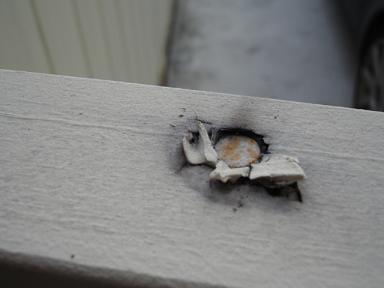

                        Do the nails that fit for this gun have plastic sleeves or casings to hold the nails together? If so did you notice any problems with the plastic sticking out of the nailing surface? Kinda like the picture below. The surface has been painted so it's not the greatest example of what I'm trying to say but I hope you get the point. Thanks.
                          Ya, that looks really bad. I shot about 250 more nails today doing some framing for a playhouse. It was the base of the playhouse and involved some pretty wet/dense treated wood. Drove in them like a champ. There was the plastic debris I had to clean up and I did notice it around maybe 10% of the nails but no where near the level you are showing. I was able to "wipe" the debris off with my hand.

                            Ryan,
                            Which nailer did that?
                            Greg

                              Originally posted by Stormbringer
                              Ryan,
                              Greg
                              To tell you the truth I'm not sure which nailer it was. The fence was built by a sub contractor when my g/f was renovating her house. Not sure which brand of nailer he used. Should of done it myself from the start since I'm re-doing most of the work he's done anyhow.
