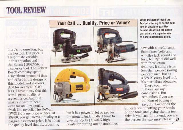

                    Drunkcat,
                    I would send you the article but you too have elected not to receive e-mail from your fellow BT3 members.
                    Here's the last page of the Article. Summary: If money is no object they feel splurge on the Festool but they feel the Best is the Bosch 1590 (as do I)
                    Click the image to enlarge.(BTW, they tested others that aren't pictured here, Porter Cable, Hilti, etc...)
                    Greg

                              Thanks for posting the summary. I have enabled my email. I was curious if the Milwaukee gave the 1590 any competition!?!
