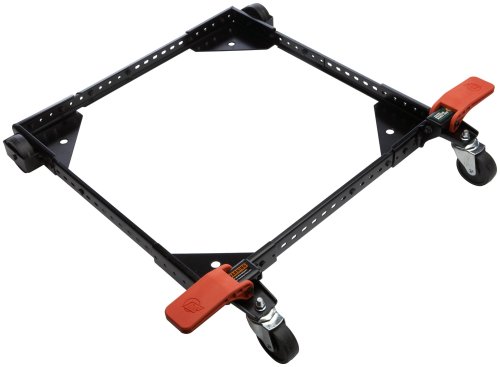

      I use an HTC2000 base for my DP (and my bandsaw, and my jointer).
      I just noticed that this picture shows different levers than the other close up pictures at amazon -- the others are the old style. Strange.

            I have one of those under my DP, and one under my jointer. The one under the DP is newer, and come with both the orange plastic levers, and the older aluminum ones. I like the big plastic ones better.
            Regards,
            John

              Also, I meant to point out that I just saw there's an HTC3000 on the market. It must be 50% better , but it costs ~2x as much.
              I think it has better leveler feet???? I didn't look too closely -- I was blinded by the $100 sticker.

                  Thanks for the info, guys. I just ordered an HTC2000 from the jungle, since the 10% off got the price under 50 bucks delivered. I want to keep the footprint as close as possible to the original, so we'll see how it works. If it's too wobbly on the DP, I'll put together something wider, and use the HTC2000 for something else.

                    Just4:
                    Here's a pic of the HTC2000 under my DP. When you arrange the HTC2000 for a small footprint, it tends to ride high on the end with the levelers. A thin piece of ply under the back end of my DP base brought it to level.
