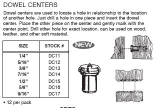

    Anybody know where I can find any of these? I'm not having any luck finding them.

        ALFA TOOLS
        Skokie, Illinois 60076-4027
        Phone:
        847-675-5030
        800-253-2532 (ALFALFA)

            Originally posted by RmeDad
            ALFA TOOLS
            Tired them already - they don't have them anymore.

              I finally found someone who carries all sizes of dowel centers thanks to someone over at woodnet. Thought I'd post it in case it helps someone else.
              Goto to www.mcmastercarr.com. You can get a tube of 6 5/8" dowel centers for $5.20. The part number is 3414A21 and input 5/8" for the size.
              They have hole centers for up to 1".
