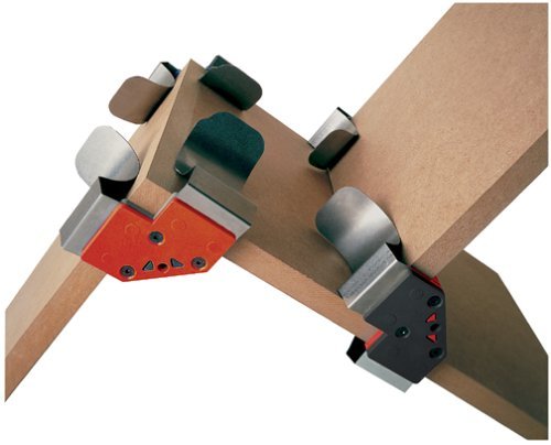

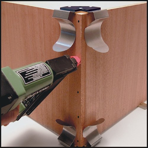

            Here's the Jet version. Amazon has a package of two for $17.74. I actually ordered them over the weekend but they haven't arrived yet. A bunch of positve reviews and their stronger build made me choose them over the Lee Valleys.

              I have a pair of the Jet's, and I'm not impressed with them. They work OK as a third hand for assembling knockdown furniture, but the springs are so stiff that it's a real pain to get them in place to begin with. They lift whatever you're clamping about 1/2" off the surface, so they come with extra outriggers to raise the rest of the object, but they only come with 2, so I usually end up having to hunt down some shims to get the whole assembly level.
              I find they're far more trouble than they're worth, except in really unusual or awkward situations (like when I was trying to assemble a 7' tall Ikea cabinet alone - they did a fine job holding the top shelf steady enough to prevent the screws from pulling out of the MDF while I attached the second side.)

                Yikes! And they'll be on my doorstep when I get home tomorrow. Does anyone know if Amazon charges for returns or do you just request a return label from them?

                    Don't rush to return. I have Jets too and I like them. I believe that Jet's idea was that for the good size project you will need few of them, not just 2. If you have several pairs you would not be hunting more outriggers. I only have one pair and often wish I had more.

                      That's an excellent point, and one that I've often thought when I'm using them. Unfortunately I think it would take at least 2 more pairs, probably 3, to be really effective for assembly. With 4 pairs, you could assemble a carcass by yourself without anything slipping while fumbling for clamps.
                      The 2-pack really does give you just enough to see how they might be useful. A 4-pack would probably let you start to capitalize on their usefulness.
                      So Greg, don't return them, buy more!

                        They worked great. the Jet ones do look a little more heavy duty though.

                          I have the jet clamps and like them. The springs are pretty tight on 3/4" material but then again with heavy 3/4 mdf, I want them to be.
                          I only have two pair and use mine whenever I am nailing or stapling 90 degree joints. Usually biscuited joints. Works great as a third and fourth set of hands.
                          Note that one of the springs overlaps the other. This helps align the boards at 90 degrees and gives you an open area for using your nailer on the other side. Hard to explain but you'll see what I mean when you try using them. Just remember that there is a correct orientation for the clamps and I believe the red vs black clamps have the overlapping spring on opposite sides.
                          I'd imagine a little paste wax would make them slide on easier but I haven't tried it.
