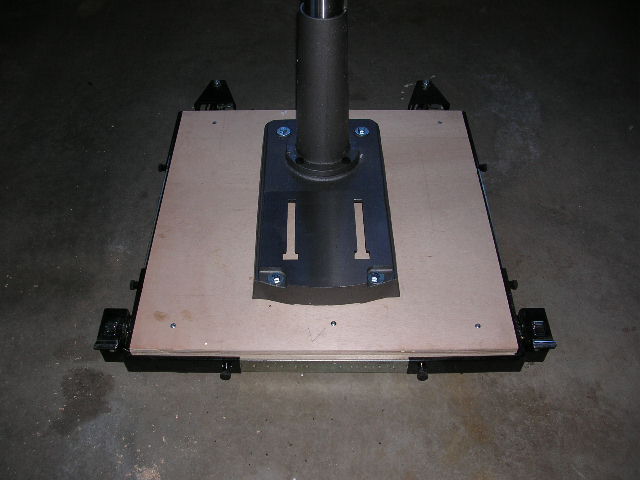

            Yes, I am a newbie, although I've viewed the BT3K forums many times, and bought my BT3K, as well as my Grizzly bandsaw, etc. due to advice offered here. I guess I was one of many on the Hitachi DP - it took me 3 weeks and 10 bucks more (135) to get my new Hitachi. I was smiling all the way home (and still am) However, my DP now crowds into my 12 X 12 workshop/shed with a Grizzly bandsaw, BT3K, Planer, Workbench, etc., and it is absolutely critical that it be mobile (and stable). I haven't seen any replies to the earlier question about a furniture dolly for mobility. My question is, anybody have good ideas how to make this thing both mobile and stable (conventional or not).
            • Larry David
              • 82
              • Maryland.
              I cut a square piece of 3/4" plywood at 27 3/4". Reinforced the back side of the plywood with a couple of 2x4's cut to 27 3/4". That sits nicely in a HTC like mobile base (Craftsman version) that I bought at Sears maxed out to a 28inch square. The top side of the plywood sits almost flush with the top edge of the rail of the mobile base. I then bolted the base of the DP to the plywood. I like it, it's stable and moves around easily. The base was on sale for $69 (I think it's back up to $79) and the wood was scrap.

                I'm thinking about going seriously minimalist.
                I think the main tippiness of this device is right and left because the base is what only 10 inches wide and there's nearly 100 pounds up at the top.
                Front to back its much wider in the base.
                So 2, 24 inch 2x 4 running transversly under the base, bolted on by the
                two holes front, and two holes rear. And four swivel casters under the ends. It'll raise the DP up another 4" but its actually sitting about 3 inches lower than my old benchtop.
                Still thinking that the all-way swivel casters is OK because, as a "Press", all the working force is applied directly downward.
                Why spend $70 on a base for a $100 DP?

                      #25
                      Thanks for the replies. I think I'll try the bolted 2X4s and castors first as I have them on hand. I also like the simplicity of this approach. I have found like new castors still attached to items in commercial trash bins (usually facing castor side up) - last find 3 inch swivel castors - plate mount. You know, one man's trash is another's treasure. With regard to mobile stands, Rockler also has occassional sales on theirs. Do you have any ideas for handy storage of chuck key, drills and DP paraphernalia? Or is that a different forum?

                            I said earlier I was going to po'boy it on this and try some transverse 2x4's and some all swivell casters.

                              #29
                              $70 mobile base for my $129 Hitachi DP
                              My $129 DP on my $70 base:
