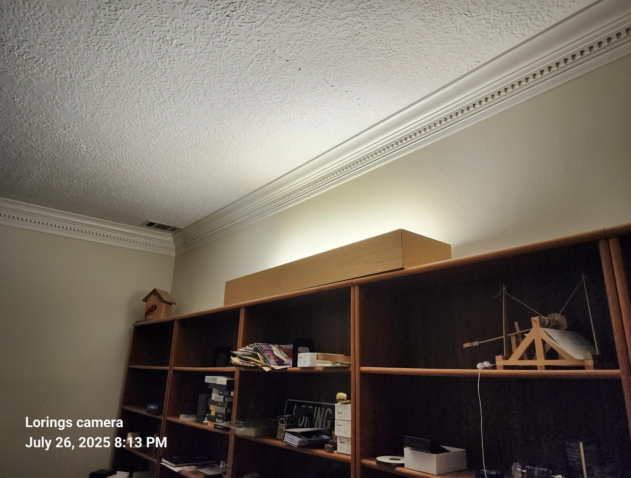

    I do have a office/study that is lit with indirect fluorescent tubes a dual bulb 4-foot fixture laying on it back in a box on top of my 6' bookshelves. (I have high 9' ceilings).

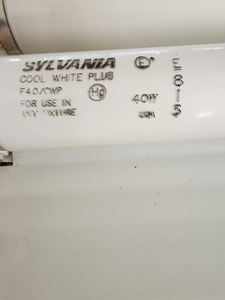

    I Was cleaning and refurbishing my office and I realized that I have had that fixture for about close to 30 years and have never replaced the bulbs or ballasts. I am sure that is is a magnetic ballast T12 fixture at that age. I haven't climbed the ladder to look at it. Weirdly, its been on a lot, but the ballasts have not failed, nor the bulbs. Being upside down, thermally better dissipation maybe?

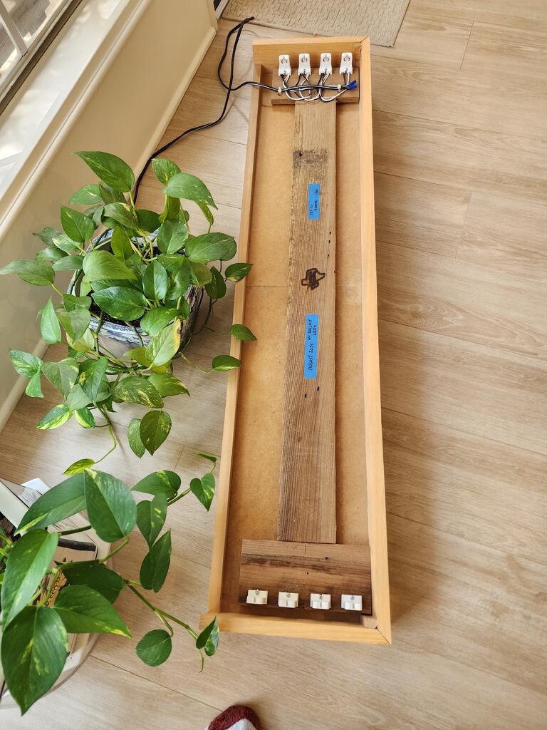

    I don't really need to use the old fixture at all, I just need eight T8 tombstones and some wire and a junction box inside my wood four sided box.

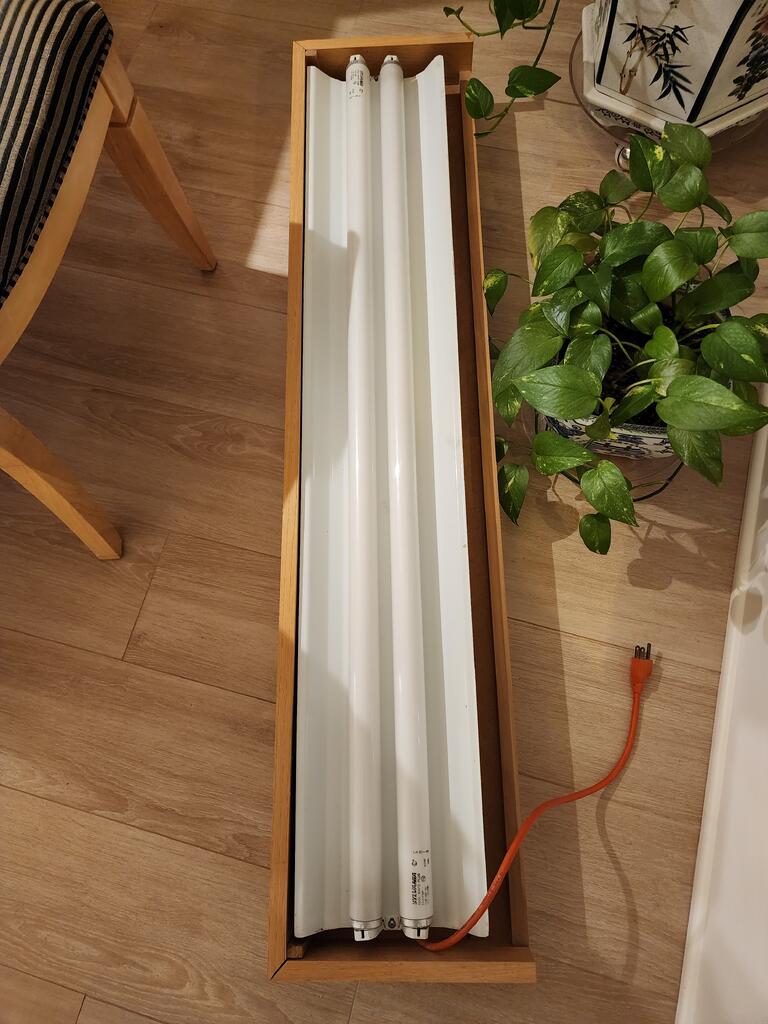

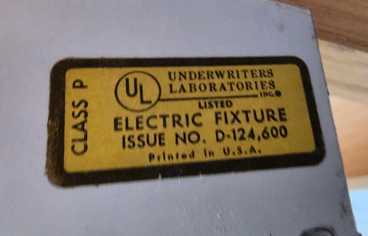

        Here's my remarkably old 33 years T12 F40 magnetic ballast shop light fixtures used for indirect lighting in my study. Redoing the study so I don't want to put it back being that old. Overdue to fail and low efficiency.

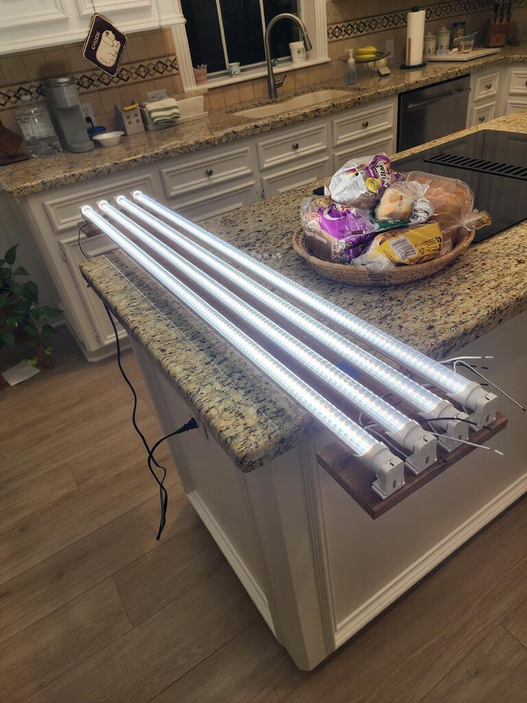

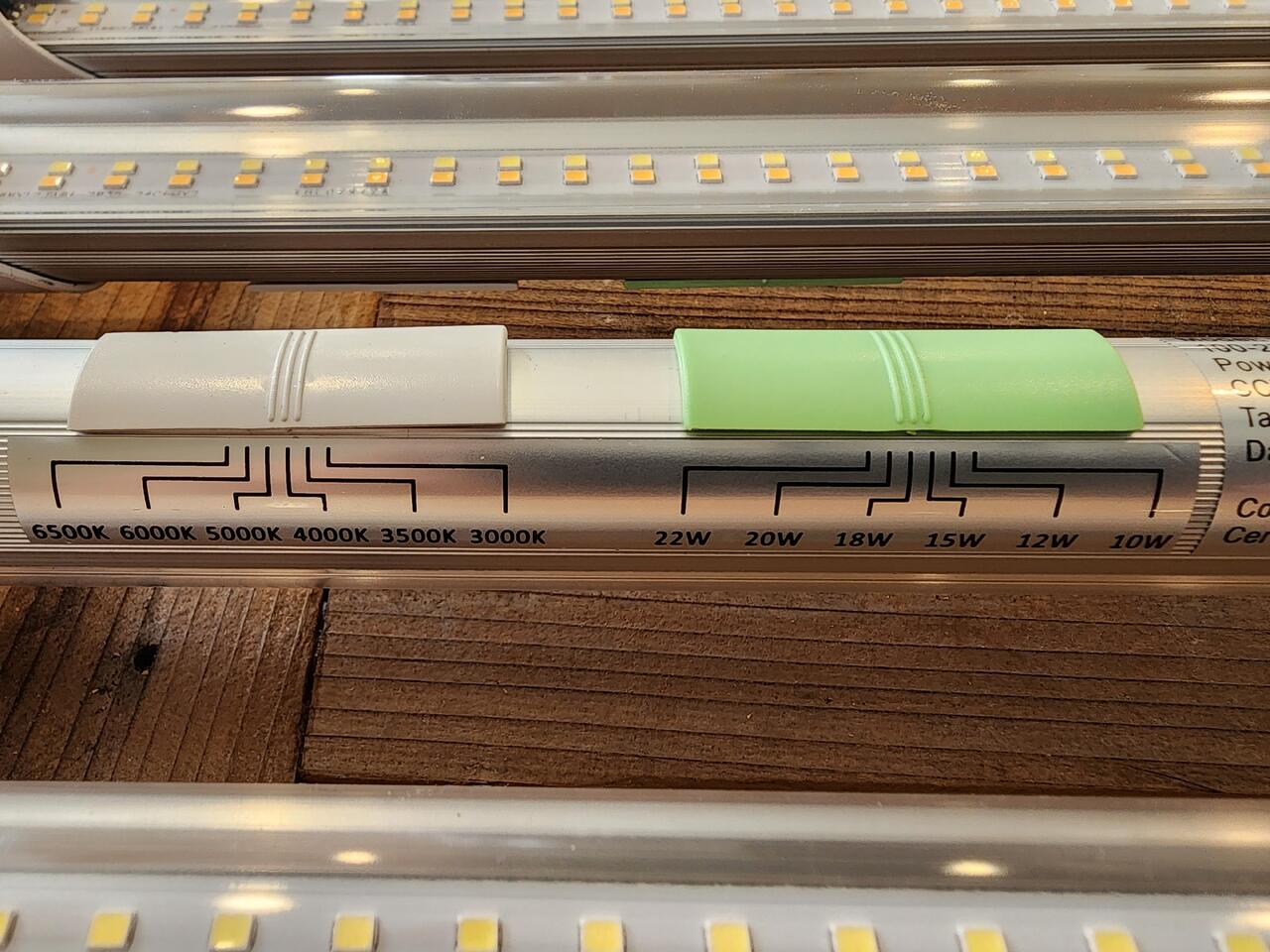

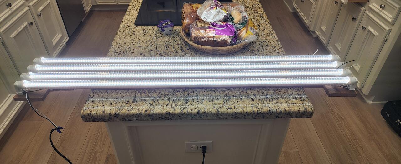

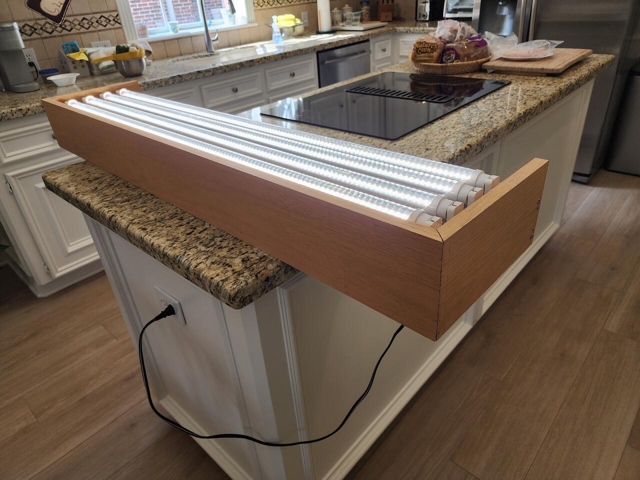

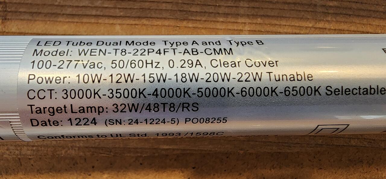

        got four new LED tubes, 10-22W adjustable, 3000-6000K temperature adjustable.

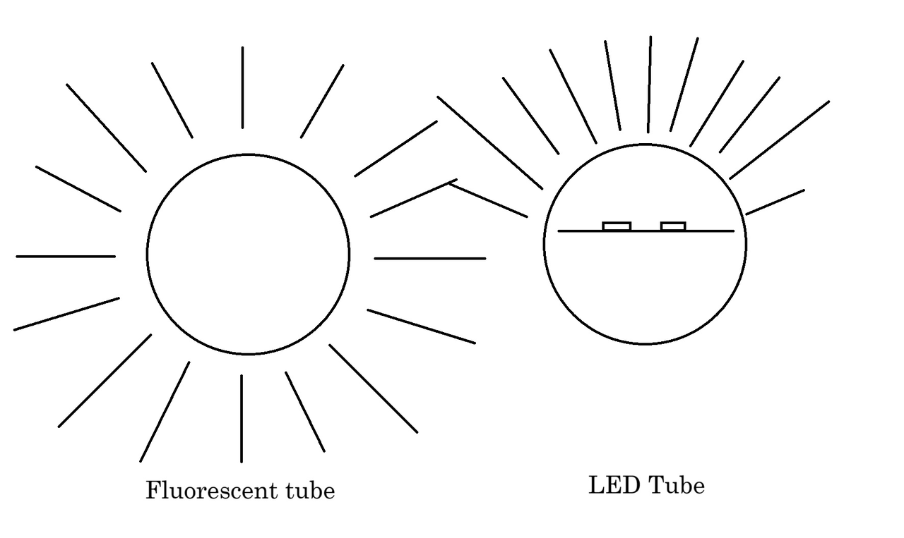

        Will toss the old fixtures, don't want to do a conversion as it has old wiring, T12 tombstones, ballast. And I don't need the reflector. Fluorescent tubes emit light 360° but LED emit 100% of light into 180°.

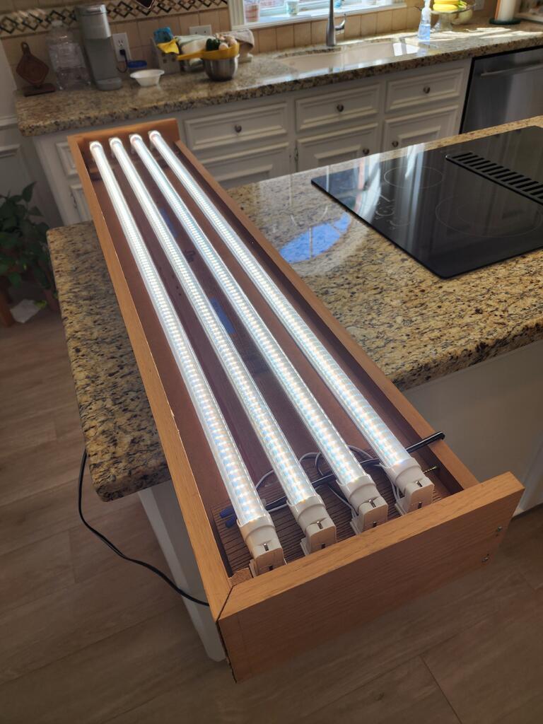

        made a small wood frame of scraps, installed 8 tombstones.
        Old T12 Fluorescent fixture: The meter said it drew 108W even though it was rated 80 and it was doubtlessly degraded lower than initial light output after 30 years use.
        Click image for larger version  Name:	20250823_132340.jpg Views:	0 Size:	121.8 KB ID:	861727 Click image for larger version  Name:	20250823_162805.jpg Views:	0 Size:	102.3 KB ID:	861723 Click image for larger version  Name:	20250823_010706.jpg Views:	0 Size:	137.6 KB ID:	861726 Click image for larger version  Name:	20250823_010655.jpg Views:	0 Size:	119.2 KB ID:	861728 Click image for larger version  Name:	20250823_162809.jpg Views:	3 Size:	138.7 KB ID:	861724
        I set the new fixture LED Tubes to 18W, 4000K. My kill-a-watt meter says 75W.
        Label and slide switches for setting.
        Click image for larger version  Name:	20250823_170222.jpg Views:	0 Size:	127.1 KB ID:	861731 Click image for larger version  Name:	20250823_170215.jpg Views:	0 Size:	173.4 KB ID:	861732

            One thing about LEDs, for the same Lumens (remember that Lumens is the total light output in all directions) the Fluorescent tube will output equally in a 360 degree pattern around the tube while the LED outputs all its light into a roughly 180 degree spread. While a reflector will turn around some of the light going the wrong direction in a fixture, its takes room, it is not 100% efficient and its own shadow gets in the way of some of it, so much of the backwards directed light is lost. Making LEDs more efficient per lumen emitted being usable.

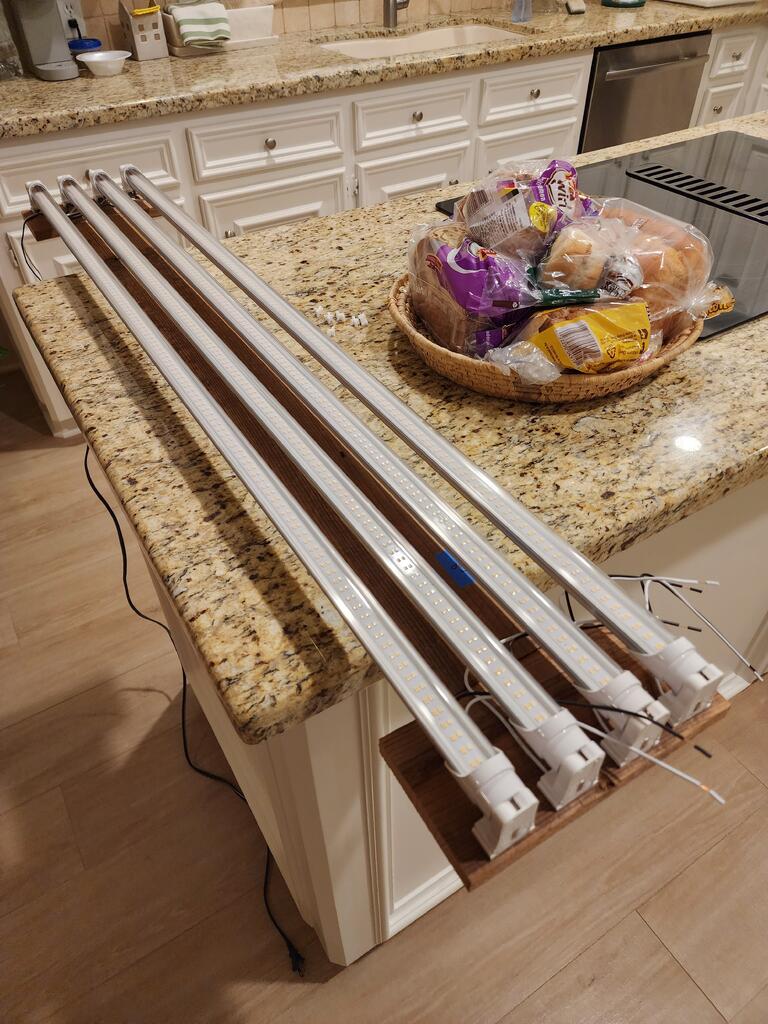

                the ones I have look like two rows of LEDs per tube, probably 96 per row spaced 1/2" apart and 1/2" between rows.
                One row the LEDs have an whiteish appearance and the other a yellow appearance. I noted as I changed the Color temperature selector while powered, that the cooler temperature settings intensified the white row while diminishing the yellow row; it went the other way when selecting a warmer color.
