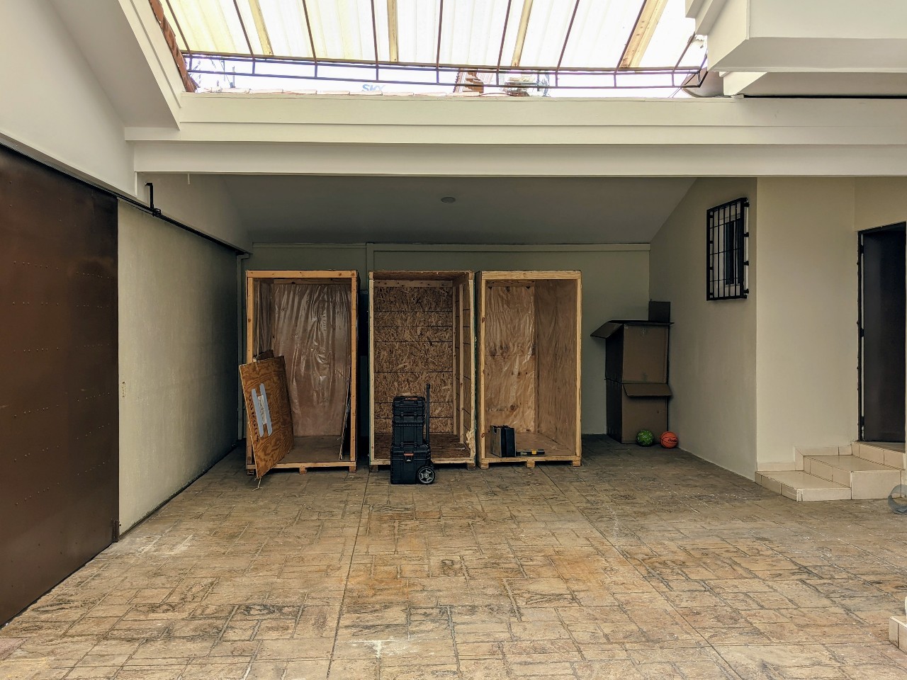

    When we first moved overseas, I grossly overestimated how much woodworking or even DIY I would be doing. Our apartment was small and any plans to build anything were quickly shot down. I managed to make a freestanding shelf for our storage closet from some scrounged scrap wood and some shelves for our laundry closet and a shelf for the entryway literally by face gluing two pieces of thin plywood together and then ripping the edges flush.
    Our new digs are much more spacious and we have this huge parking area in the front that could easily fit 4 cars if you could Tetris them in. We have one car, though.
    When the movers delivered our stuff last week, they left me 3 of the wooden crates. Each of them measures almost 4' wide, 7' deep, and 7' tall. There's a housekeeper's quarters to the right of the picture which we're using as a storage room since we only need a helper one day a week. Instead of cluttering up that room, my wife was easily convinced to use one of these crates for my "shop".
    I've decided to use the particle board one since it's the largest and sturdiest--no bounce in the floor--and I'm going to disassemble the other crates for projects like a Tiki bar I want to build for the patio.
    I'm going to spend the rest of the day pulling staples. I'm thinking of making a fold-down bench top for the back. The whole parking area is covered. Heavy rains will sneak through that gap, but there's a generous overhang that the crates are quite deep in and never get wet. I may leave the door facing out like this or turn it to the side. Not sure yet. I'm also thinking I might want to cut a door on the long side and use that for entry, but also not sure yet. Let me know if you've got any ideas. I probably have triple of what you see in this picture for tools, etc.

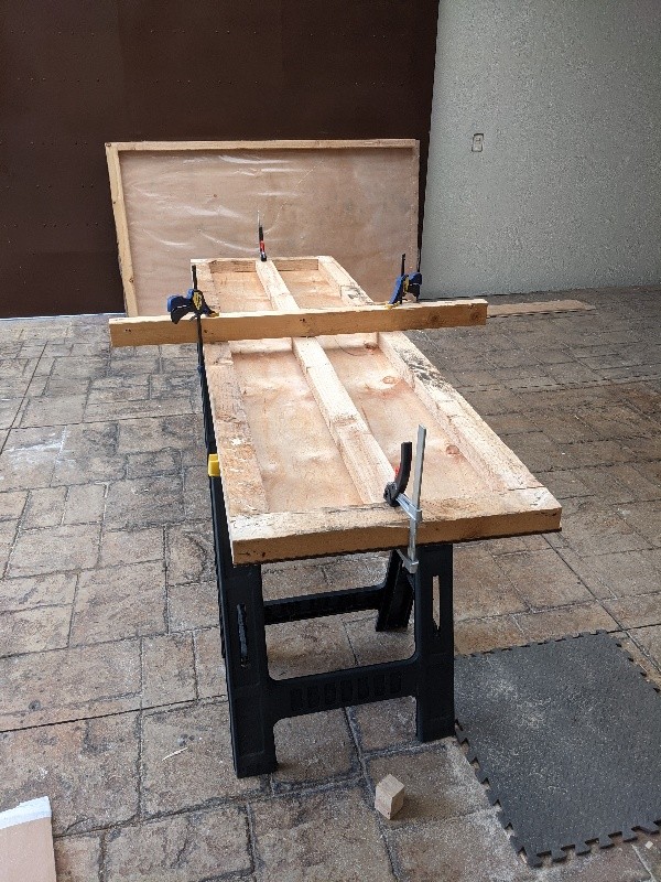

        That crate on the left came apart pretty easily. The lumber frame is light weight and the nails and staples pulled out pretty easily. The crate on the right, however, is stapled together and uses regular 2x4s which is holding on tight to those staples. If I try to force it, I'll end up damaging the plywood too much. I think I'll wait for my circular saw to arrive so I can cut the panels loose.
        I've decided to build some desks for my kids but I need a workbench. The skid on the one crate already had a nice layout so I cut it down the middle to one side to give me a 2' x 7' surface. Then I glued in that center beam with my kids' school glue, and afterwards glued on a plywood top skin and nailed it to the beams below. Now I've got a pretty nice torsion box. Not dead flat but good enough.

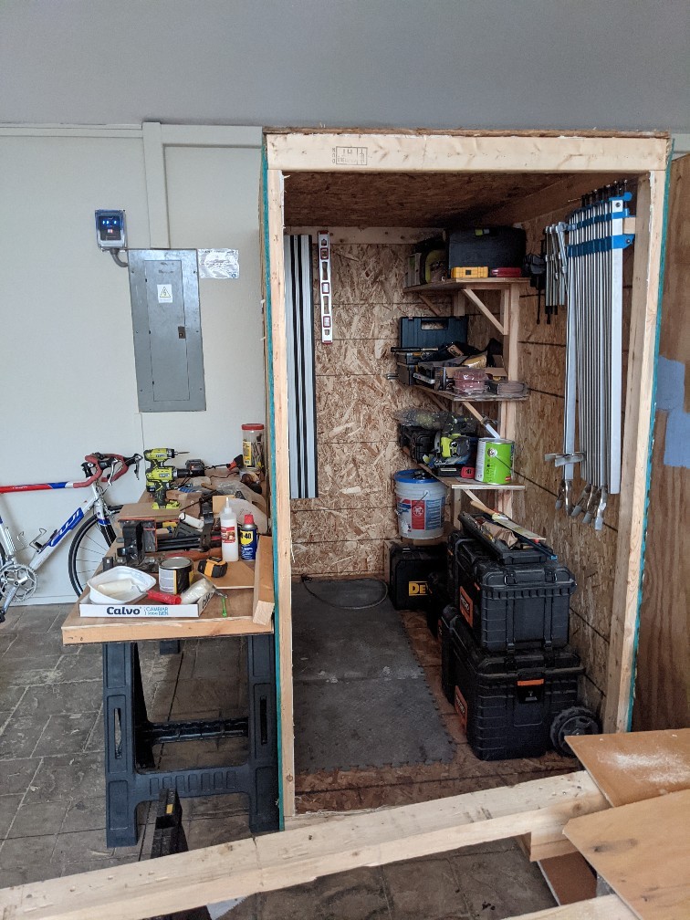

                I've also been trying to organize my "shop". We have a housekeeper that comes once a week and sometimes I'll hear her sweeping out there even when I told her she didn't have to. My mess must be driving her crazy.
                That crate bottom I was gluing up earlier is now attached to the outside of the crate with hinges and rests on two plastic sawhorses. It can fold up against the crate wall (assuming the bench top ever gets cleared off) so I can store things in that nook of the garage to allow the car to get in/out easier.
                The crate walls are thin so I screwed a wood cleat onto the wall from the outside to mount all my clamps. I also fashioned some angle brackets from scrap crate lumber and then face glued some plywood for the shelves. I can buy metal shelf brackets relatively cheaply but waste not want not. The glue is cheap and plentiful here, too, and I've used up most of a 1 gallon bottle already. I think I will relocate the clamp rack as it takes up valuable wall space in the storage shop.
