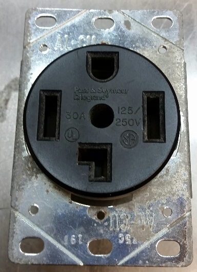

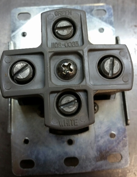

        Was considering not using a NEMA twist lock plug for this new outlet. The ones for my TS and BS stick out quite a way from the wall. I have this extra 30A, 250v outlet. Could I connect just 3 wires to this (2 hots and a ground) and find the corresponding plug and connect the black, white, and ground wires to match? Should I run a 4th wire for just in case later? I'm thinking for this outlet, if I ever move, I'm taking the whole run with me.

          • 3790
          I'd feel a lot better running the 4th wire now and connecting it to the ground of the new machine. Arguably the same thing as the neutral wire but done for safety reasons.
