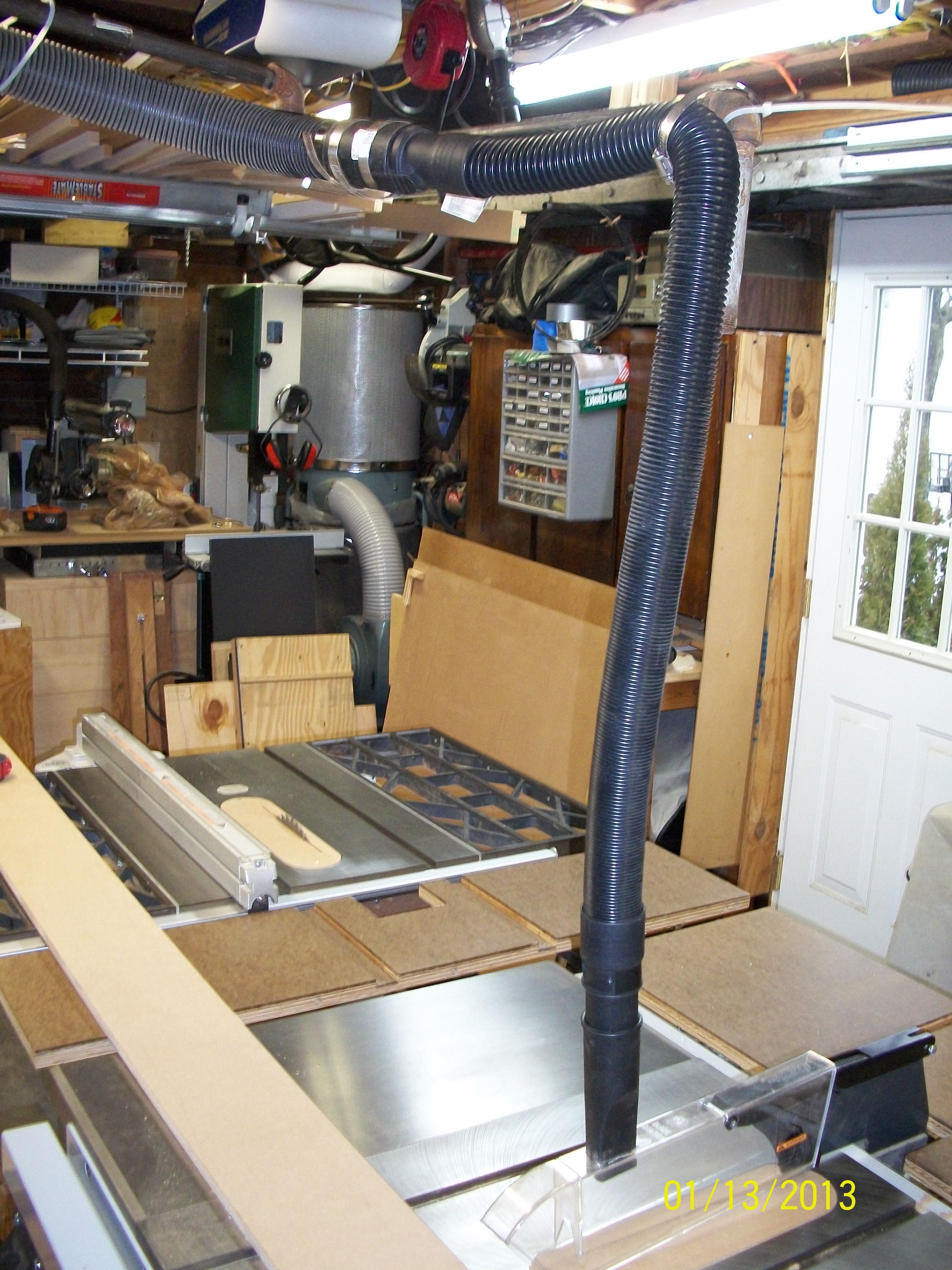

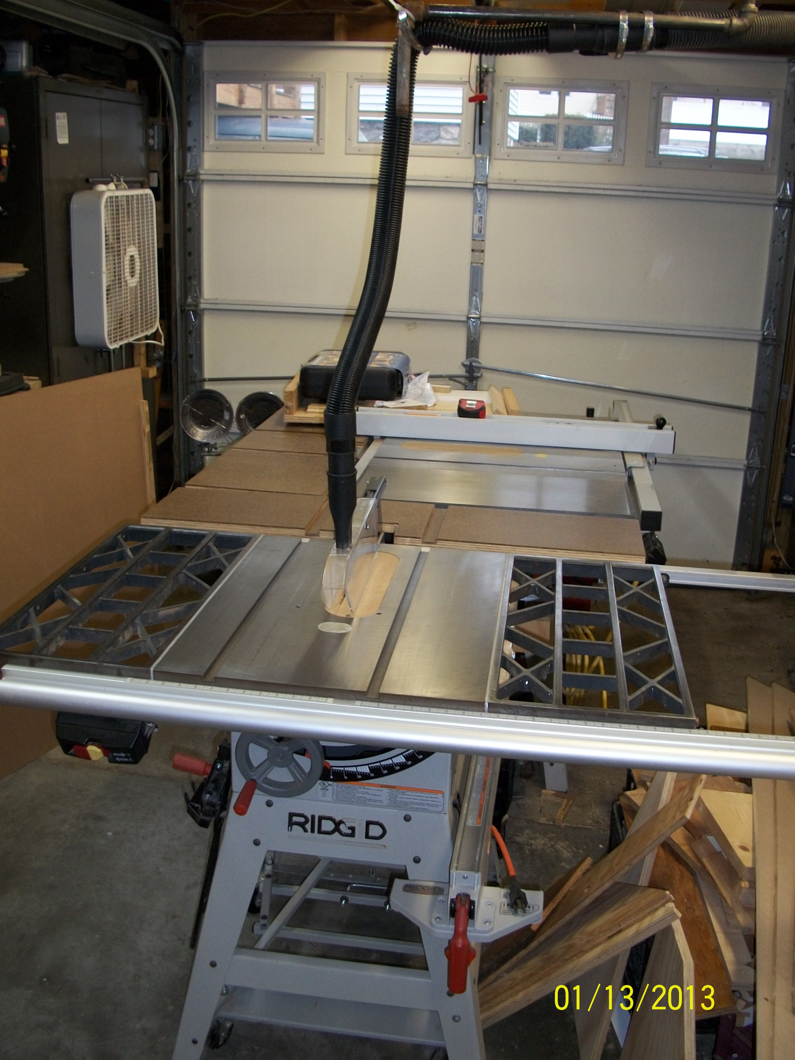

    ghetto version.
    i had some 1/2" pipe and fittings laying around and pulled this together in an attempt to get better table top dust collection. my shop vac powers the blade guard dust collection while a 1.5hp DC collects from the cabinet. shop vac and DC are activated automatically with saw activation via daisy chained ivac switches.
    pretty it's not but preliminarily it seems to be fairly effective. and when not in use, "folds" out of the way. and with it's two swivel joints, it can be configured to service both of my 10" TSs.

    Very nice, does Tom Hanks know you found Wilson?
      Very clever. I can imagne a couple of uses for a setup like that in my shop.
      Do you find it to have "solid" feel when moving it around?

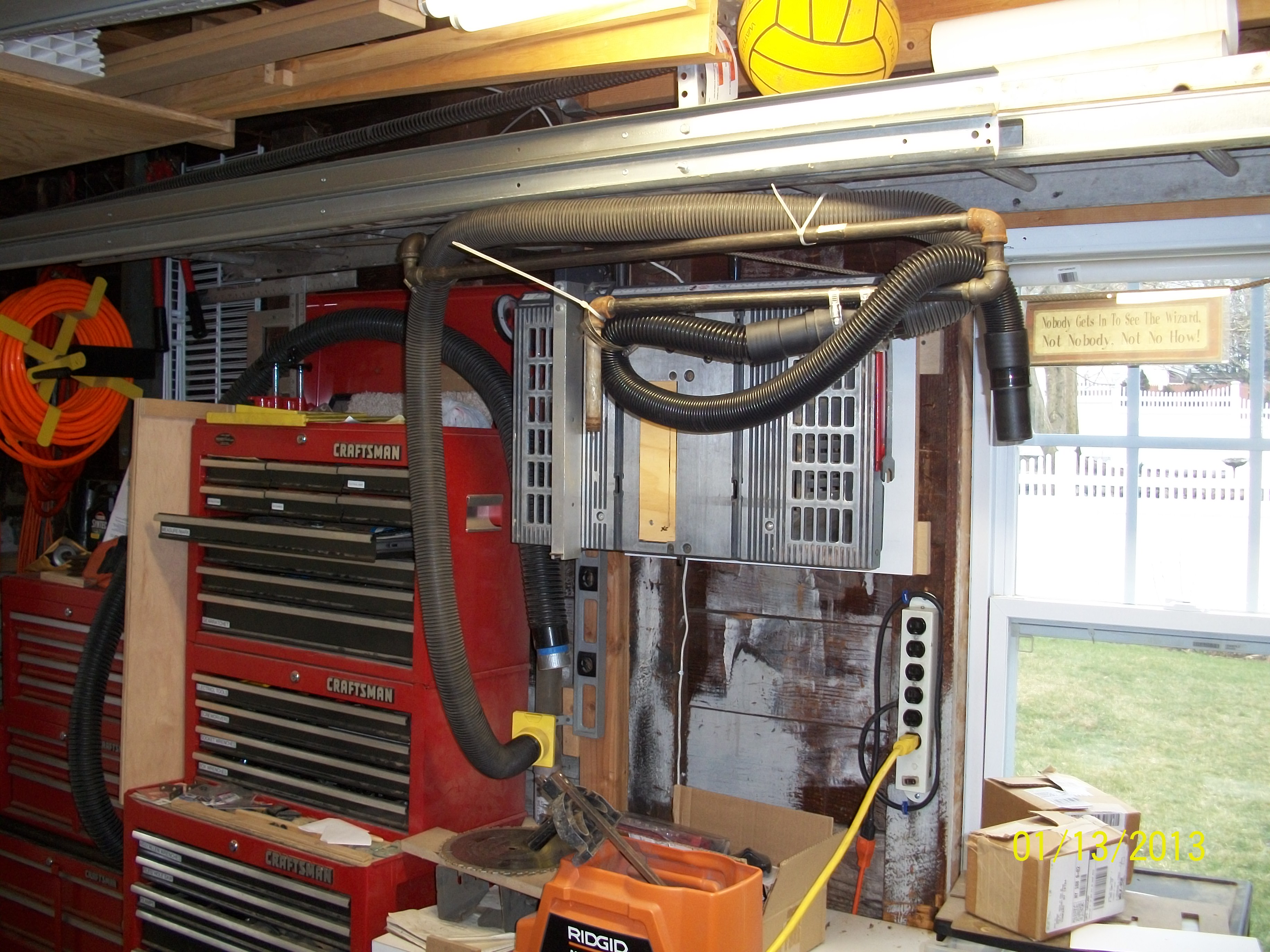

          yes, as i snugged up the fittings to where the tapers of the threads fully engaged their mating threads. the arms don't actually move much more than 90* each. just enough to swing over the two emerson built 10" contractor saws. it'd be a little better to use 3/4"pipe and fittings, but i removed a 1/2" gas line from the boiler room and decided to re-purpose that pipe. i've done similar brackets for my shop built air filter and the fan hanging on the front of the tool cabinet in pic 3.
          ps There's no shortage of tablesaws in your shop! Are hoarding in case the Sawstop mandate goes through?
          no, but it's nowhere near as crowded as it was in october when my refurbished unisaw was still there (since sold).
          and that little c-man on the wall doesn't really count, does it? i only use it when i'm asked to help out friends. i don't trust their tools, so i bring my own. i was really surprised at how accurate that wall hung POS can be made to cut
            That's really cool toolguy! Very useful and well planned out. Cost is good too! I was wondering why you had a t.s. mounted on the wall - glad you said why it was there, I was having images of a t.s. doing plunge mortises
              • 22054
              ha ha, I only saw two table saws. I thought maybe that thing on the wall was an air conditioner, but it didn't quite look right.

                  To toolguy, I like that. why are the TS perpendicular to each other?

                      Originally posted by atgcpaul
                      .......To toolguy, I like that. why are the TS perpendicular to each other?
                      with a 12' X 20' shop, space is at a premium. the ridgid is for ripping and stows against the rear wall under the RAS table extension. the souped up c-man stays where it is and is for crosscutting. the c-man is also the outfeed table for the ridgid and i can rip 8' lengths (including sheet goods) with the garage door closed.
