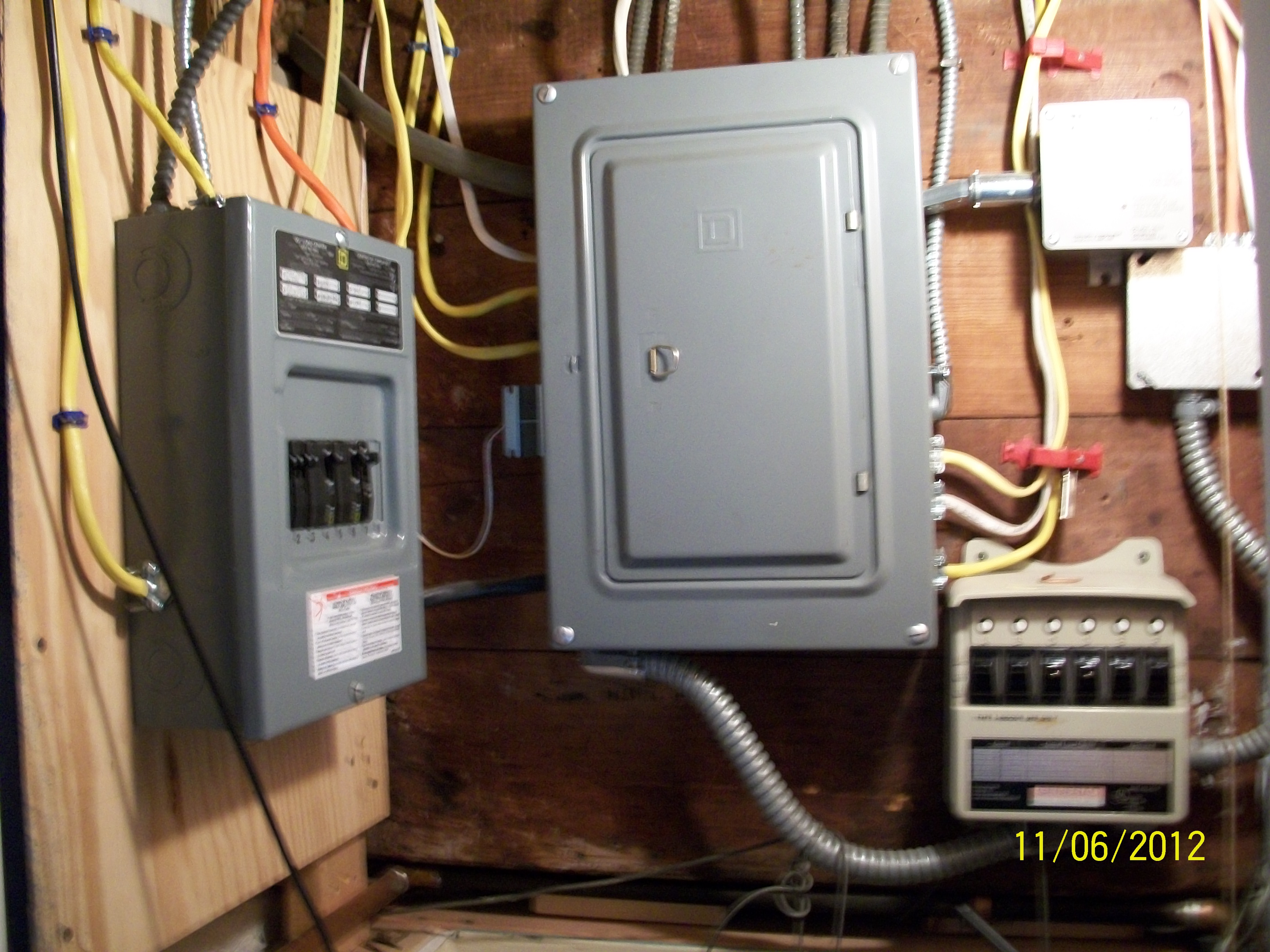

                while you are doing exactly what i've done (and it's been blessed by a licensed master electrician here in NY), it may not be approved in your jurisdiction, so i'd verify that first. i would follow the suggestion to change from full size to half size breakers, as long as the circuit count for your main panel isn't exceeded (spaces and allowed circuits counts are usually printed/stamped into a panel box or cover).
                being in a suburb north of NYC, we have natural gas for heat, HW, cooking abd drying, as well as municipal water. our demand for electricity is relatively low with the fridge and central AC (the primary reason for the sub panel) being the heaviest consumers. and yes, i run a 3 ton central AC system off my 60A subpanel and have NEVER dropped a breaker or even seen the lights dim when the compressor activates. load balancing is very important.
