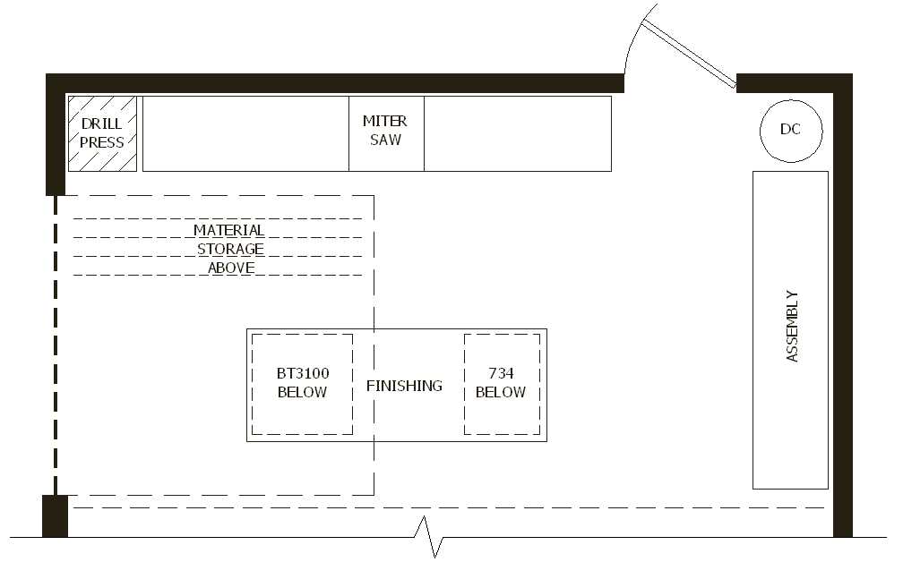

            Small shop space
            Thanks for the good input guys. The space I have is 11' x 25' (1/2 of my garage). Naturally one side is the roll up door and I've decided to store my raw stock in the space above the door. For the most part I have one full wall ~18'. (then the side door) The back wall is about 11'. My BT3100 is on a custom rolling platform with locking feet as is my Dewalt 734 on a flip top cart. Those two units fit into bays under my finish workbench. The remainder of the stations are set up for a clockwise build rotation with an assembly bench that has casters but almost never moves. I've attached a quick sketch so hopefully it will make things a bit more clear.

                From your drawing, you should have tons and tons of space relatively speaking. So I have to ask the next big dumb question....
                Do you know, or can you take the time to learn Sketchup? It's pretty easy to learn, and beats the tar out of constantly moving things physically around to decide if you like a layout or not...
                If you can get going with that program, look in the 3D Warehouse for BigDaveF150 (that's me) and feel free to use any of my models... That's why I put them there in the first place...
