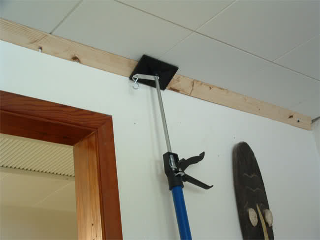

        OK. Make the cabinets with a hang rail. Pick up a couple of these. You can use these to hold up cabinets from the floor, even at angles. Both ends are gimballed. Here's a pic of how I use them for installing crown by myself. This picture is a backer on concrete for wood crown.

          Yes! That is an excellent idea. I had seen those before but thought they were way too pricey. I haven't figured out whether it is more economical to use up the 3/4" for the backs or to get another sheet of 1/4" prefinished on 1 side and add a hang rail on top of that. Will have to check availability and price tomorrow. Thanks for the ideas!
