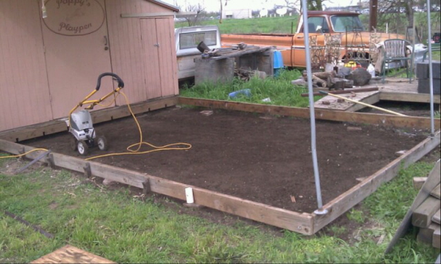

    Phase one was to get the old plywood off and tear out the old joists. I got that done on Tuesday.
    Yesterday I took the electric tiller in to bust up the dirt and remove the excess that had settled from rain runoff ovr the years. I removed about 10 wheelbarrow loads yesterday and got the ground fairly level.

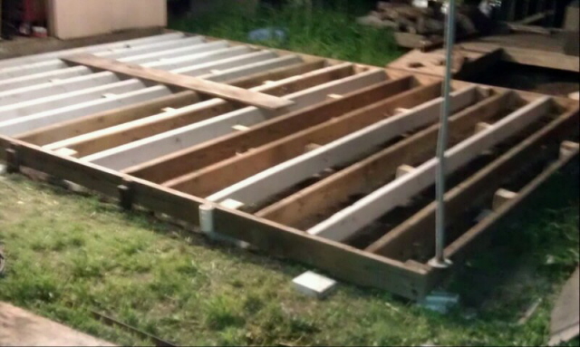

    Got a start on Phase 2 last night before I quit. I cut the new joists to length, selevcted the best of the old ones to reuse, and nailed the hangers on the ends.
    Today I got the joist in the frame, leveled the frame work, and added the support posts. 4x4 posts @ 4' along the perimeter and 2 rows every other joist under the T&G joint for the decking. The header board was attached to the shop with lag screws and had pulled out over an inch on one end. I reattached it with 6 carraige bolts.

    Have you considered adding some joist blocking? It's probably not necessary with all your mid span supports, but it would help in stiffening everything up.

        Is that an electric tiller in picture one? Does it work well?

          No blocking. just made sure the joists were all pulled straight as I screwed the plywood down.

          Yes, Ryobi electric. Works ok for light work with the sand tank full, but I wouldn't want to till a large garden with it.

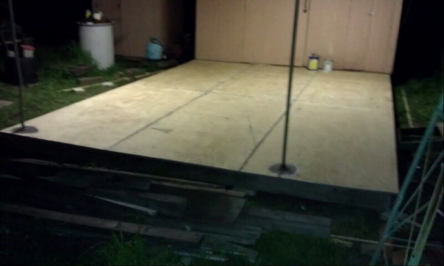

            Got the plywood floor down today. A lot of time to paint the edges good and roll a seal coat on the bottom side.
            Screws every 9" along the building and around the outside. A screw in each joist about 1" in from the edge of the ply and 2 across the ply. (40 screws per sheet.)

            Obviously I got it dirty walking around while screwing the ply down. I will make a fast cleaning pass with 100 grit before putting down the first coat of floor paint.

                not to be critical, but shouldn't those seams have been staggered?
                  Chop, only 1 1/4 Acre.
                  toolguy, normally they would be but i wanted to be able to pull the section near the shop if needed. There is a full joist under both sides of the end joint.
