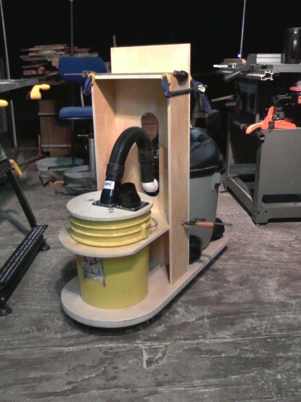

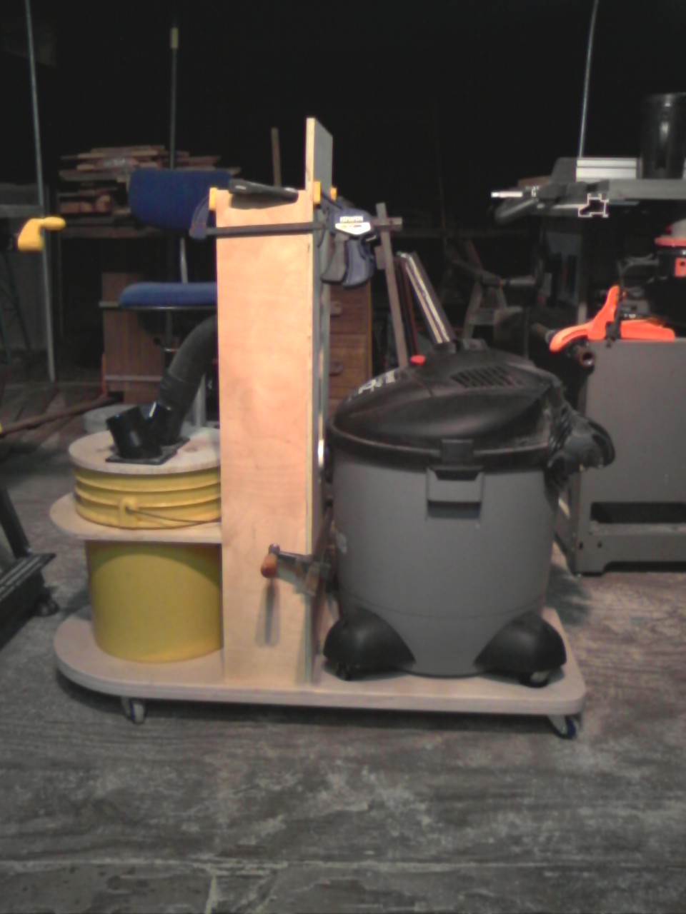

              I'm going to design something where the vac will ride on or with the separator, so a very short length of hose between the vac and separator is needed. But even at 16', plus about a foot or so inside the separator, it worked. I'm thrilled it worked at all.
                This might give you some idea for a mobile vac/seperator.

                  Thanks Pappy. I'll be spending a little while gathering ideas. I'd like to find some way for it to be either compact enough to slide under something, skinny enough where it could be vertical, or where a tool could sit on top of an enclosed structure.
