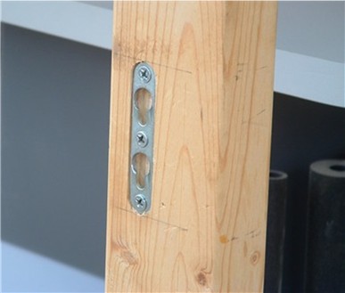

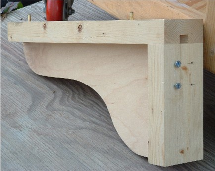

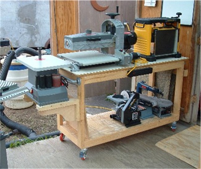

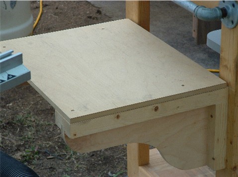

    You can build one cart/stand for the planer and OSS but you will fun into a problem with the working height. I have my planer and WDS bolted to the top of a table and use the bottom shelf to store bench top sanders and my scroll saw. A removable shelf on one end puts the OSS at a comfortable working height.

    Thought about, but never did, adding a second set of brackets to mount the shelf higher for the belt sanders and scroll saw.
    BTW, don't scrimp on the casters. These are heavy tools, especially the planer. The loaded weight of my cart is over 400#'s. Cheaper casters may handle the rolling weight but the swivel bearings are single row and will bind up when you try to steer the thing. PM me and I will give you a source / point of contact for some quality casters.
    In your case it might work as well to build a 2 level top that would keep the planer and OSS at the right working height. Vac and seperator could go under the talller side for the planer.
