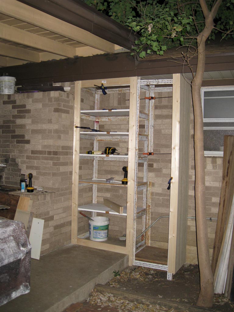

                  Some photos; I'd explain some of them, but that was several Guinnesses ago...
                    Erik, why is the shop vac on the roof? I know you said that this was after several guiness, but?? :P
                      Hehe, it's a normal thing. I can't just leave it out on the ground. Seymour, my only male, thinks it is his. He'll mark it often if he sees me using it. Especially if I go inside for more then 5 minutes and not threaten him with death before I go in. There's not too many things worse than grabbing a vac attachment that has been sitting for a while in a cup of his urine.
                      It usually goes inside the short storage addon. I was using the sawhorses and other things earlier. It's prety light without the blower motor on it.
