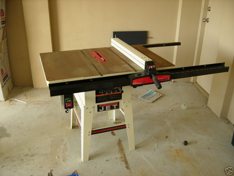

            You should have seen me searching for a replacement saw over the last few weeks. Sold my BT3100 about the time I started busting the concrete up. Needed to remove everything from within the garage and knew I would want a larger saw. So 3 weeks ago, I started scouring Craigslist. Hundreds of ads, phone calls, emails and miles later, I snagged a Jet 10" in good shape. A little surface rust but it runs smooth and quiet. $200.
            Yes, that would have been $200 towards concrete. However, the extra cash was from a distant relative's will. I felt the only right thing to do was to purchase something that will potential be handed down to other members of the family. Not a whole lot of money but like I said, a distant estranged relative. There were no tangible items willed.
            The picture is not my actual saw. It is however, the same model and pretty much in the same shape. The guard was included along with several plastic push sticks, 4 blades and the dado throat plate. Granted, most likely the blades are junk and I would never use metal throat plates, opting to make custom ones.
