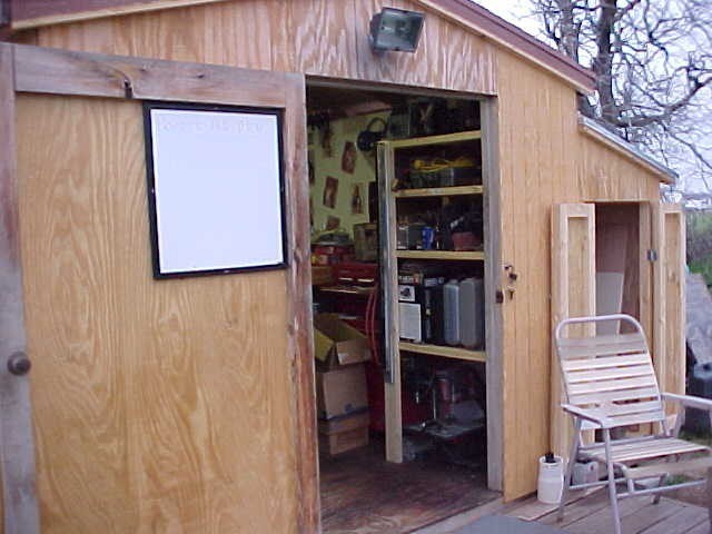

    Early this year:
    Now: (anti-clockwise from door)

      Remove anything not shop related. Any items out there for storage etc., find 'em a new place. The space is valuable, and it will be even more valuable as you accumulate more toys.
      Get that woodpile away from the shed ASAP. I did that on mine, I had to replace the lower 30" of T1-11 along one side. I also had to use a bunch of chemicals to kill the termites that were moving in.

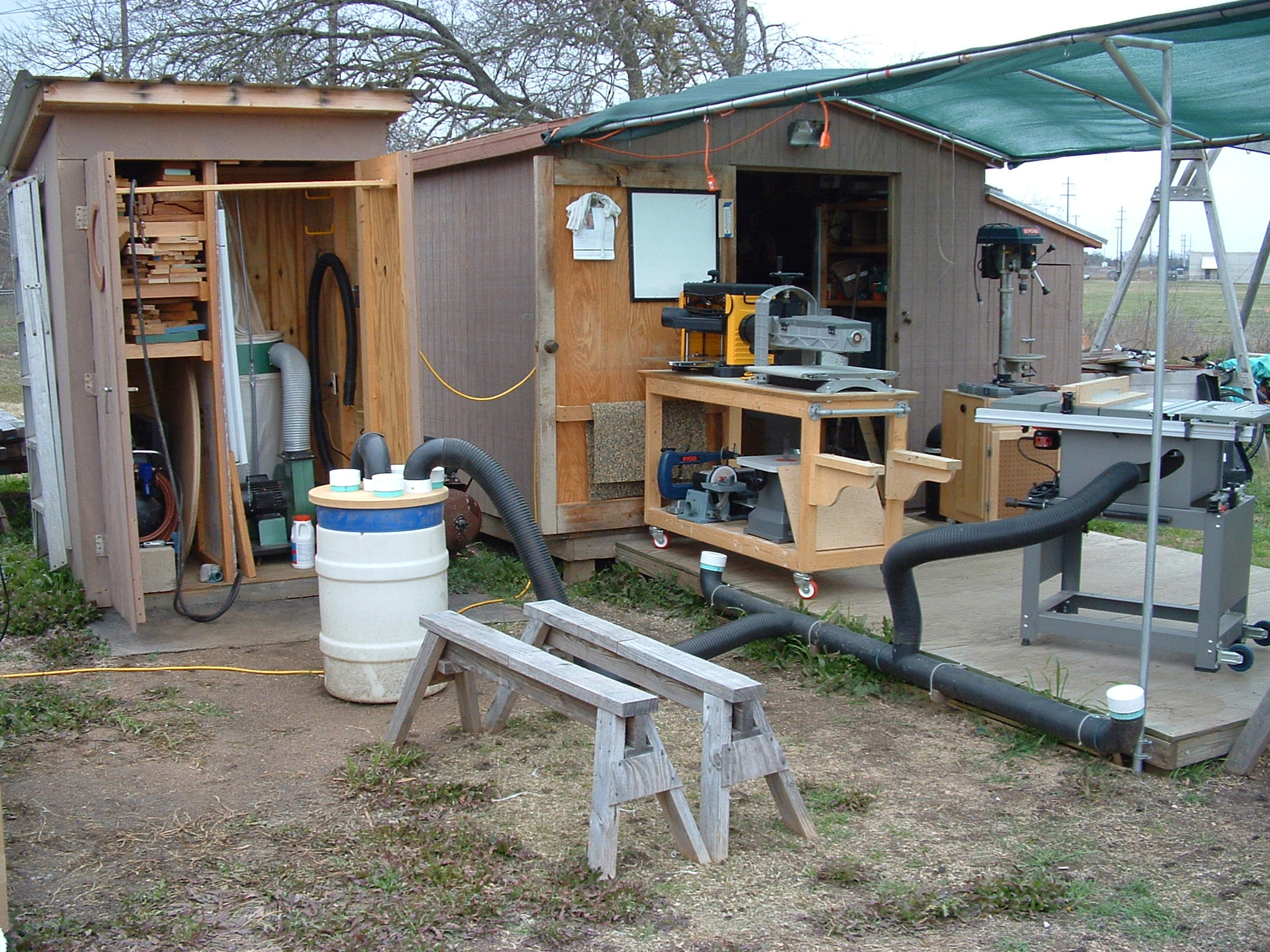

        Here is an idea, painful and a bit expensive, but if you really think you're not going to get more equity out of the house by adding a permanent shop why not build one that you can take with you when it's time to move on? My brother has a 18x24 that is a temporary, sitting on blocks with a skirt. It wasn't cheap, but he moves for work quite a bit and instead of looking for a place with workspace he finds a place where he can drop it down.
          Like you and Erik, my shop is a shed. Add a PT plywood deck in front to give you a level work area. (Mine is 12x16)
          Check with a camper dealer for a male receptical that can be mounted in a box. I have my DC and compressor in a small side building and run power to it this way. I also used one under my trailer when I was drag racing to power my trailer.
Name:	DC system.JPG
          The add on to the right serves as wood storage. Erik has the same set up but his storage area is larger easier to access. I plan to rebuild mine to a similar size to his.

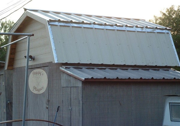

          Another option, if you can't go out, go up!

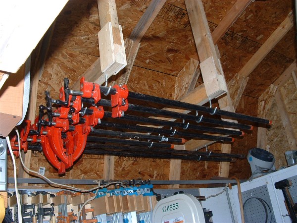

          The supports are now covered with cut down used hollow core doors for project/supplies storage. The tops of the cabinets are now usable space and braces on the other side hold saw boards and router guides.
