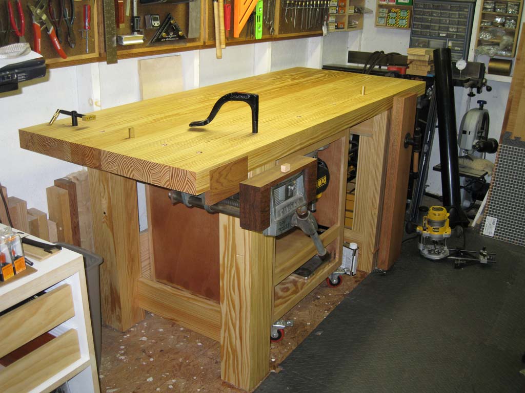

          I’m really glad I built mine longer than I first intended. The extra real estate on top is nice to have. I ended up going with a 76” long bench. I started designing it for a 5’ top but mounting the vices and leaving clearance for my flip top planer cabinet to roll under was getting problematic. I looked into doing a layered MDF top, or plywood & MDF etc. I always ended beck up with a wood top; mainly for use with traditional hold downs. I could get a longer cantilever on the ends without fear of any sagging. There’s some info on it in this thread: http://www.bt3central.com/showthread.php?t=45506
          The latest issue of Popular Woodworking has a nice smaller Roubu inspired bench by Chris Schwarz. http://www.popularwoodworking.com/aug10 He plans to put it in some of the living space upstairs in his house. His book, Workbenches is a pretty good source too.
          I think you could be pretty happy with a little bit bigger of a bench and also use it as your outfeed table, as long as it works with your shop layout. You’ll loose some shop floor space, but gain a stable work surface. I’ve gone from a B&D workmate, to a plywood top on sawhorses & other solutions, and finally to a decent bench. Having a nice, heavy duty bench is certainly a pleasure.
