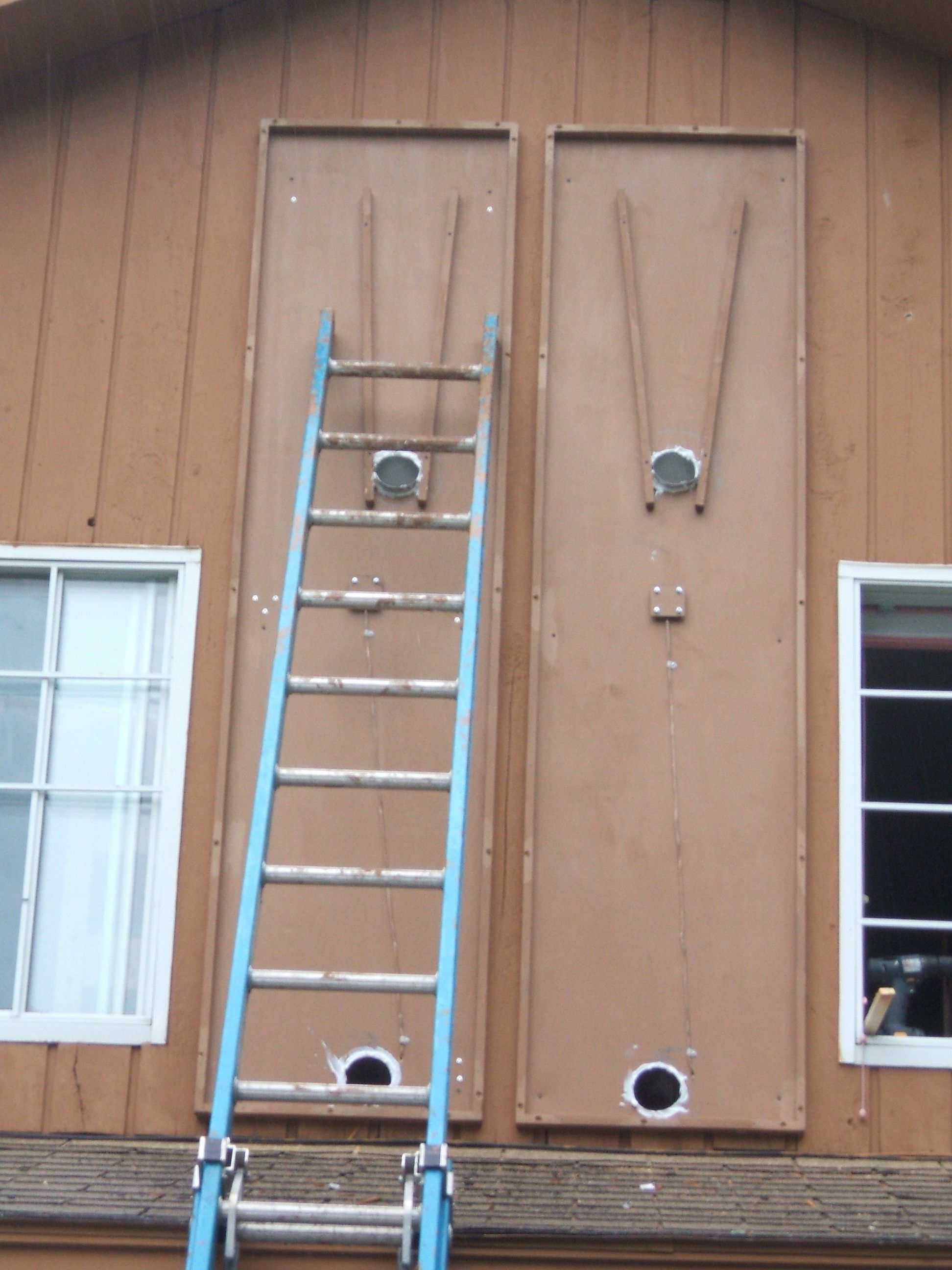

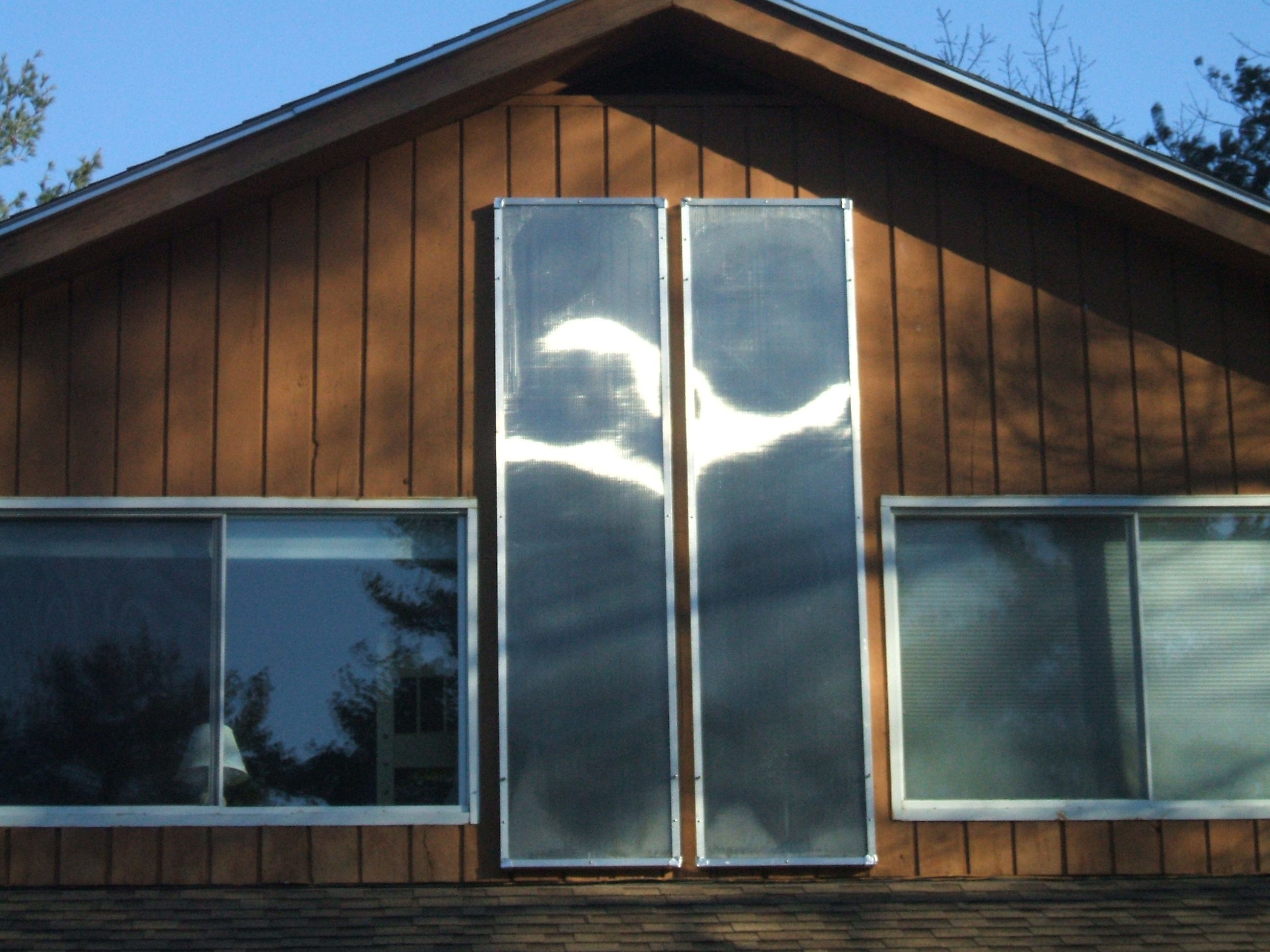

                      In the pictures below the white stuff in the first picture is caulk. You can see the snap thermostat cover in the middle of the panel, and the top whole is in the middle with a baffle because the panel is taller than the ceiling inside.
                      1) I have two panel each heating one room. Each panel is based on a 2X8 sheet of half inch plywood.
                      2) The basic panel is a box constructed with the 2X8 plywood framed with 1 X 1 1/4 inch pine. On top of the pine frame (the sides of the box) is a sheet of 2 foot wide aluminum flashing that I painted flat black. (I also drilled a line of 1/2 inch holes at the top and the bottom flashing to let air circulate.) On top of this, a strip of 1/4 inch thick pine, and then finally a layer of the corrugated plastic glazing that is used on green houses. This whole sandwich is screwed together, and then framed with 1 X 2 inch aluminum angle.
                      3) The basic box is screwed to a south facing wall of my house. (I didn’t bother with insulation since I figured that the house wall was insulation enough). I mounted the open box with a few big screws, The flashing, glazing and frame were installed later.
                      4) The connection to the house is through two 4 inch aluminum drier vent pipes that were cut through the building wall. One is at the top, one is at the bottom. The top one is capped with a drier vent louver that prevents “thermal siphoning”, that is cold air from back cycling into the house at night. The lower vent is capped with a muffin fan to blow air through the heater when it is warm enough.
                      5) Once the plywood panel is installed, and the vents and the wiring (below) is installed the flashing, glazing and frame can be installed.
                      5) The electricals: In the middle of the panel (protected from the flashing by a small plywood cover) is a “snap thermostat”. I chose a “close on rise” snap disk thermostat that closes (completes the circuit) when the temperature rises above 90 degrees, and opens (turns off) when the temperature drops below 70. If I had it to do over again I would have gone for 100/80 or something like that. The muffin fan is a 12 volt fan. The nice thing about these is that you can control the speed of the fan by changing the voltage, so I bought a radioshack transformer that had a switch on it for voltages between 3 and 12 volts. The truth is I have never used anything but the highest setting. The snap thermostats were kind of hard to find when I made these, but in the last few years they have started to show up on solar DIY sites.
                      6) I built a box that mounts the fan over the lower hole and has a switch and a plugin for the transformer. I also added slot to hold a piece of furnace filter to keep the air clean. The circuit runs from the transformer to the switch to the snap thermostat to the fan and back to the transformer. If you want you can also wire in a low voltage room thermostat since things are 12 volts. I did, but have realized that in the winter nobody is going to complain that your room is too hot, so I just crank those to 90 degrees. My advice: don’t bother!
                      7) The way this works is that during heating season you switch the fan on. The fan will go on whenever the snap thermostat is closed, which means that the panel has heated up to at least 90 degrees. The fan runs forcing cool air at the bottom of the room into the panel, and forces hot air out the top. At night when the panel cools down the snap thermostat opens and turns off the fan. The louvers on the top vent close, and the panel shuts down.
                      8) For the summer I installed four bolts sticking out of the outer aluminum frame. I use those bolts to hold a 1/4 inch plywood cover over the glazing. Not really necessary, but I figure it effectively shuts down the system during the hottest part of the year.
