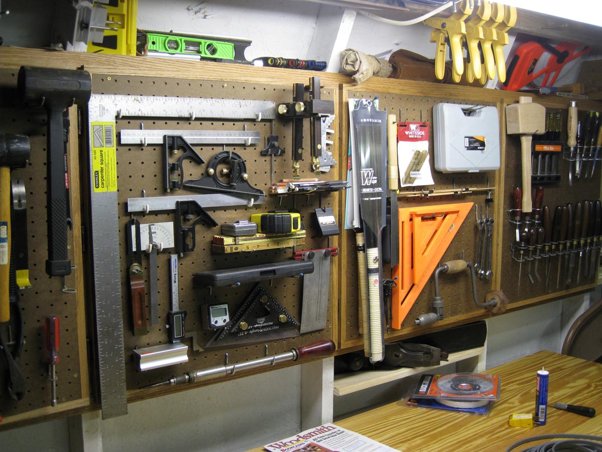

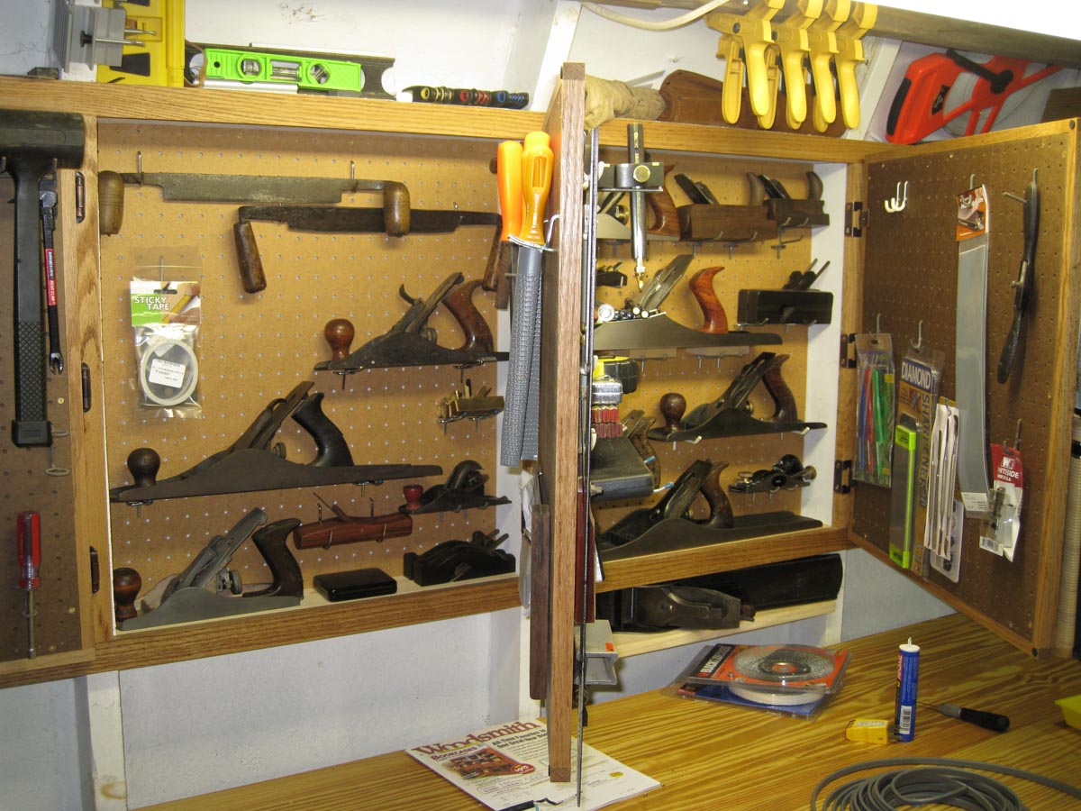

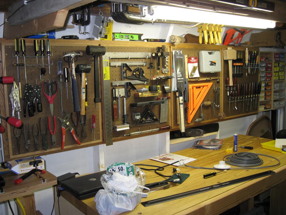

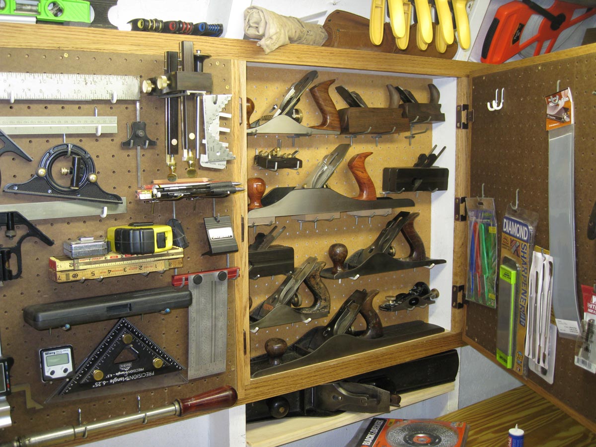

    I've got a very limited amount of space in my 10x12 shop. I've currently placed my planes inside my pegboard door cabinets that use the stud space above my bench. Except for my Stanley/Bailey #8. It ended up on it's side on a shelf below because of the 24" length. I'm running out of room and I'm sure there will be more to fit in there soon. I tried putting the #8 on the outside of the door, but it really messed up the layout of my other tools, especially when the hand saws had to move.

              I like the way yours are set up with the exception of the ones on the bottom shelves. There needs to be a spacer under the sole to keep the iron from touching the shelf. You may have this and I just can't see it in the pictures. The other option is to keep the iron retracted when in storage, but I find that to be a PITA.
                The irons are just retracted right now on that #7 and the ones on the other side. I had some 1/8" spacers out of hardboard, but the dogs thought they needed some new toys and they grabbed them when they were sitting down on a chair while I was rearranging for the most recent aquisition.
                I've considered doing some storage that would put them all on their sides with the soles against the back. I could probably get the most density going that route, but I haven't figured out a workable solution to accomodate the depth of the needed. I tried loosing that door that my frequent users are behind, but I hated where my saws and squares ended up.
