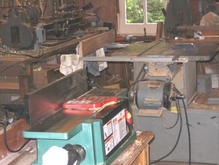

    Well, I got my new jointer Monday and now it's set up and working. I'm glad I chose the Grizzly 6X24. It seems to be well built, all cast iron. The only exception is the plastic fence adjustment handles. It's made in China, not Taiwan, but stuff from China seems to be getting better. Test runs resulted in surface quality that needed no sanding. The only problem is that when I start moving the board to change grip, lines show in the wood. I guess I'll have to learn how to keep the board moving. I'll see if the photo I attached gets to this post. Haven't done that before.

          Nice piece of iron there Tom. I assume you set your out-feed level to the top of the blades and that's not's what's causing the lines. As mentioned keep direct pressure off the top of the cutter-head. Just grab some scrap and practice as it will come.
