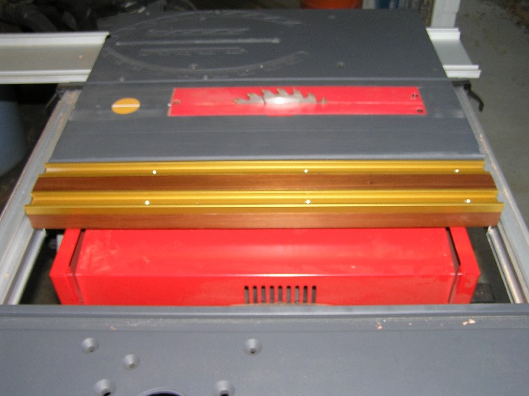

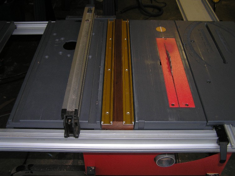

    Nothing fancy - but I have an upcoming project that requires use of a cross-cut sled, so I took some remnants of Incra miter track and reclaimed scrap redwood (old growth, tight rings, very dense), and built this simple unit, which I have finally got around to mounting on my 21829. Made some mounting brackets, and used some of the original large square t-nuts and 5/16 bolts to mount it to the rails at ~1/32in in below height of main table. Tracks are parallel to within 0.003 inch, and parallel to blade within the same. Thanks for looking.

    Looks good and should be very functional. Added something similar to my table a while ago.
      That's cool. I did mine with a miter slot, and a T-Track slot and fastened them to the saw rather than the rails. I used to think I would shift the rails on my 21829, but once I added a half rail set I never move them.
      How'd you get a hold of a second 21829 accessory table?

          Thanks Joe - I hope it works for my sled. My only question is: is there a benefit to using two miter bars on my sled (being that the two miter bars would only be 1.5in apart), or is one good enough?
          Erik, I don't think I'll be moving the rails - after I took the time to get them DNO to use the rule on the rail for my rip fence, I really haven't needed to move them.
          And as Charlie indicates, I purchased the second 21829 accessory table from Sears parts. They were not around used when I was looking. That is a must-have for me, because most of the time, I leave the two butted up against the main table just for the extra rip capacity to be available when needed. Also, I have my first acc. table set up with a router (to back up my dedicated router table), and I can put the second acc. table in front to create more table surface for the router when I need it.
            If I did mine again, I'd probably mount it to the rails too.
