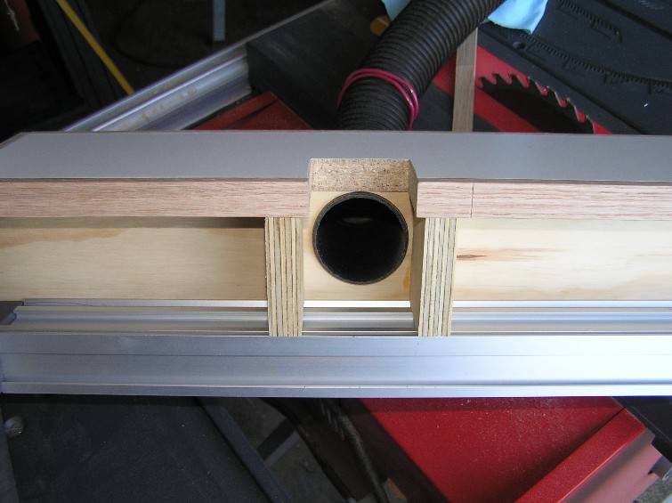

    I have a couple of projects coming up that required me to build a tall fence for my 21829. I still have melamine leftover from a sheet I used for several other projects, so used it to create a simple tall fence I could mount to my 21829 fence.
    Also, I had made a one-piece router fence for my 21829 (since I use this router to supplement my stand-alone router table), but I dropped it the other day, and it broke in half! I was so disturbed, I actually threw it out - and forgot to remove the metal mounting brackets .
    So I decide to finally build a taller router fence with simple built-in dust port - out of ... melamine! And I used 3/4in ply for the mounting part.
    Both fences mount using the original t-nuts and star knobs (I forstnered in some recesses to accommodate the knobs.)
    Thanks for looking.

    Might consider beveling the router bit opening, would look good and prevent possible hangup when feeding.

          Good suggestion on beveling the outfeed edge of the opening - I did just that, but with a small sanding block to knock down a minimal amount, and it works great.
