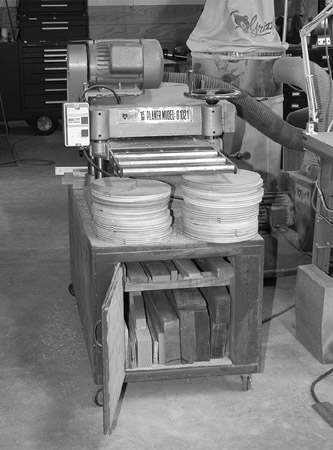

          You said you were looking for ideas, so here are a few photos to give you a few more. The combo stand you showed us was pretty good, but at JR said, it is going to be awful heavy, so don't try to use $3 casters on each corner, or you will soon learn what hernias are.
          Twenty years ago, I bought a planer but not the optional stand. I try not to have 'machine stands' in my shop, but rather build my own so they all serve double duty. My planer base holds lots of wood scraps.
          Miter stands are neat and cost usually around $100. Mine cost one 2x4 and a few scraps of ply. I wanted it to be portable so it could be easily moved to a work site. For one job it was used on the floor quite a bit, but I'm just getting too old for that now a days. You might consider making your wood stand a bit bigger and using a portable miter stand that you can move out of the way when not in use. The last photo shows my wood stand, but no way could it be on casters. It holds lot of sheet goods, with other layers over it for hardwood. Not suited for your purpose, but just shown to give you a few more things to think about. Good luck!
