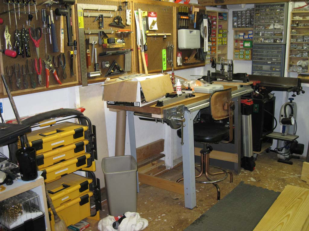

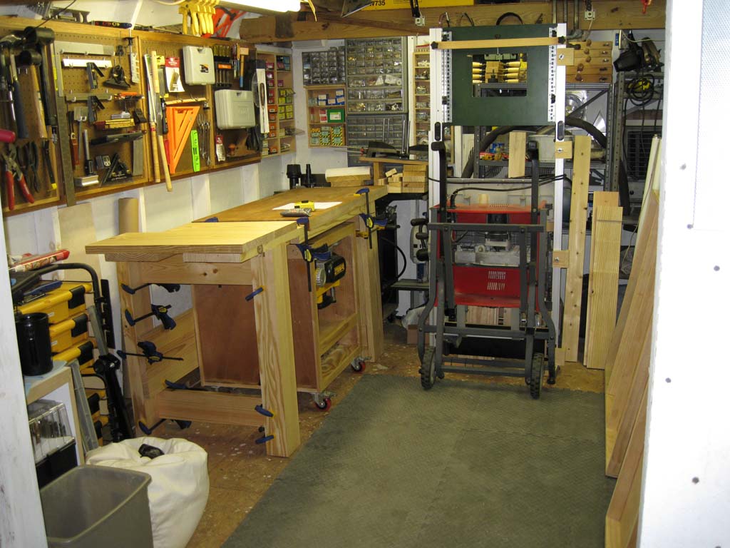

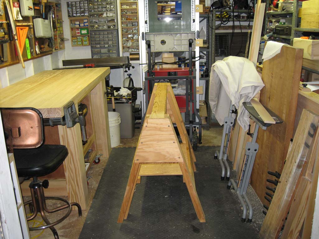

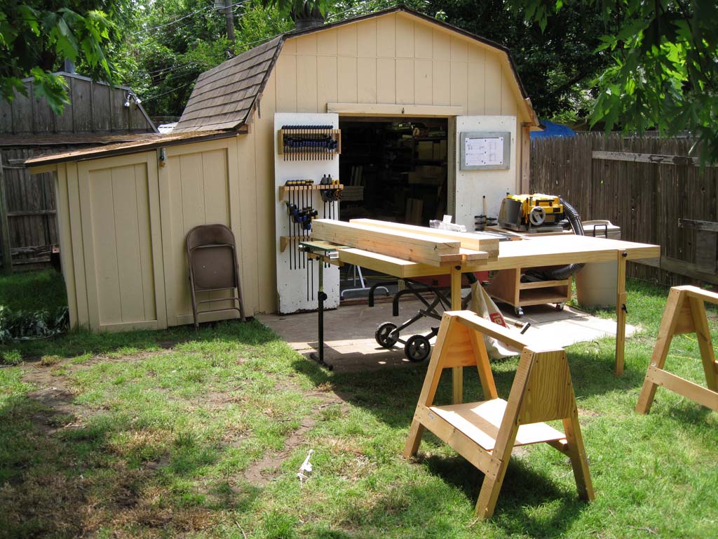

    Wow, 12x12! that would be an upgrade for me. I'm currently working out of a 10x12 shop/shed. I added a 5x12 portion to the side for wood storage. Pappy has a similar setup.
    The big thing is mobility. I don't know what I'd do without my 21829. Most all of my power tool cutting gets done in front. Planer on a flip top cabinet, router table built in the end of the saw table. Short jointer on wheels. Drill press on wheels too.
    I'll see if I can get some pics up soon.

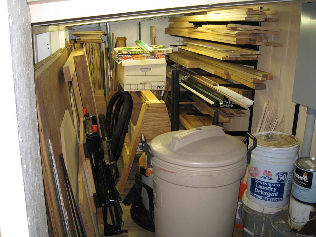

        Here's a few recent shots and some older ones. The open spaces get filled at the end of a session.

          Certainly didn't mean to sound like I was insulting anyone's shop. Sorry if I offended.
          Pelligrini, I'm seriously jealous. There's something about a dedicated space that I'd take any day over a shared space.
          Seriously, I'd kill for that shop. I'm also amazed that wood storage area is only 5x10. Seems a lot bigger, but I'm guessing that's just because it's so well organized. I'll check out those other threads you suggested.
