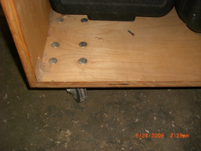

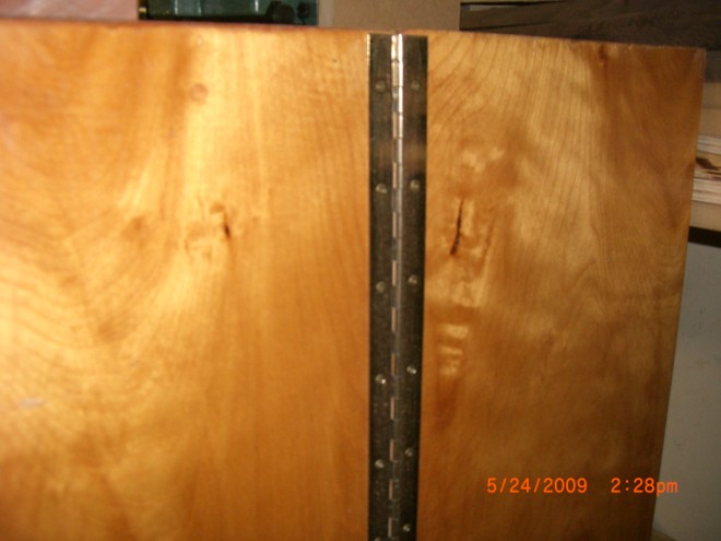

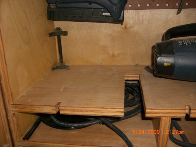

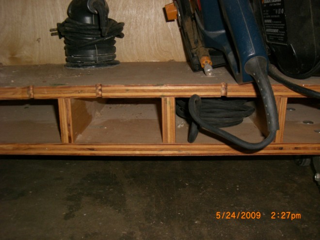

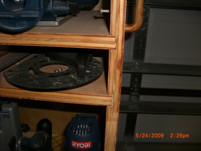

                          Mike, I'm not sure what exactly you wanted to see, so I took some more general pics. It's all made from 3/4" plywood. Each half of the shell is 33"x60" and 12" deep. They are connected by a full length piano hinge. The top and bottom are rabbeted into the sides. The shelves are in dado's. The pegboard has 1/4" spacers behind them for clearance of the pegs. The backs are 1/4" plywood just nailed on and flush trimmed. When fully opened it is NOT very stable, which is why it's up against my lumber rack, but closed or in a "v", I can roll it around with no problems.
ID:	784228 Click image for larger version
ID:	784234 Click image for larger version
                          Look there is dust!
ID:	784230 Click image for larger version

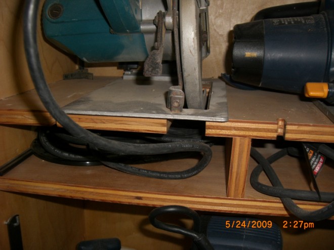

                          Slots cut for circular saw bladeguard
ID:	784231 Click image for larger version

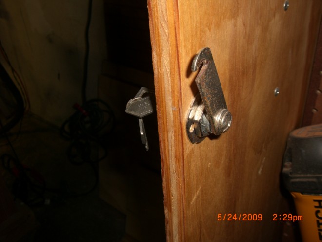

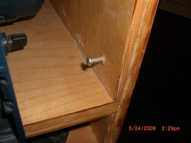

                          This screw is for the lock to catch.
